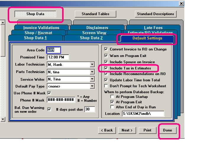

Re: Removing Taxes from Revision
go to set up/shop data/default settings and un check "include tax in estimates" this will not put tax on revisions.
i think that is what you are looking for.
The only problem with removing the Tax from the revisions is that it does it for everyone. I'm looking at just removing Tax from my non-taxable customers.
