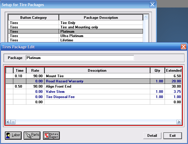

Is there a way to attach a road hazard warranty charge to a tire? I would like the road hazard fee to be a percentage of the price of the tire. It would also need to be optional.

if the tire is an inv item you can attach the rh to the item. the rh would also have to be an inv item, if you want to keep track of how many you sold. To my knowledge the program does not calculate a % of the sale price, that would be user entered.

This can be defined as a line item in several ways:
1. Tire Package (below) level of service specifics
2. Canned Job with the Road Hazard as an option managed thru Part Kit
3. Attached Part method attached to actual tire records or tire template record
- hazard.png (25.57 KiB) Viewed 2712 times
