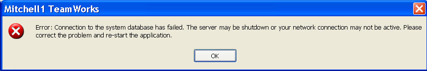

I have run into a problem while trying to remove customers from the database. I was wondering if anyone else has run into this at all. This has so far only happened on a select few old customer files. When I try to delete the customer from the system I am getting an error message that reads:
We are not having any server connection issues. Everything else in the programs works fine. Although, we have restarted everything as it says, just to make sure and the problem persists. Again, this has not been with every customer, it has only happened with 4 customer files. If anyone has any type of fix for this, please let me know. Thanks!

This type of issue will require tech support intervention to see what's up with those specific records.

We have had this issue - I did have tech support poke around & while they helped me delete the offending records - we were unable to figure out why it is happening. The only correlation I can come up with is that some of these customer records in the history tab have no customer information listed for earlier work orders. This has come from the vehicle being transferred either from our inventory or from another customer.
debc166 wrote:I have run into a problem while trying to remove customers from the database. I was wondering if anyone else has run into this at all. This has so far only happened on a select few old customer files. When I try to delete the customer from the system I am getting an error message that reads:

Years ago i had an issue with ones that were never used after being transferred to mitchell from my old operations system.

This goes back to my previous question, regarding the error message above that I was receiving. I have found that all of the customers I am unable to remove have a last visit date of 8/10/05. I believe this is around the time when we did switch software programs. I have not yet called tech support on this, however, I decided to play around with the customers to see if I could find what was wrong. On one of the customers, I created a new invoice, which updated the customers last in date to todays date. I was then able to delete the customer without any problems. Is there any way to update the customer's last in date without having to create new invoices for them?
Re: Removing Customers
Good detective work. Likely some weird artifact from the import process. If it were me I'd just leave them in there. The records are not causing any harm. If you must remove them, looks like a one-at-a-time process.
That's correct. It is the actual invoice activity that updates this internal value.
It doesn't generally occur unless a database conversion has taken place. It has to put something in that field and probably defaults to the databse conversion date.
