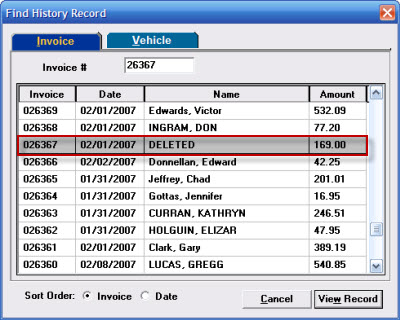

Permanent (RO/INV) numbers that end up deleted are not re-used.
If you press F4 (same as Utlilities - Find History) and select the Invoice tab, you would see any recent [100 most recent INVs displayed] deletions like this sample below. If you need to account for an earlier INV # you may type it into the window provided and it will bring it up.
- deleted.jpg (48.38 KiB) Viewed 6443 times
