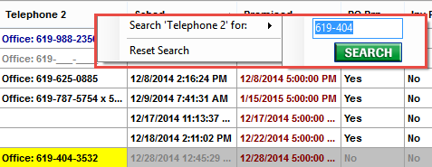

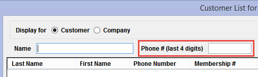

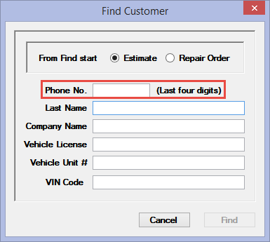

The NEW / F6 window to lookup customers and the F3 Find Customer function both indicate that the last 4 digits are used to search on: On the Work-In-Progress screen, a right click on a Telephone field reveals a Search box where *any* portion of the phone number may be entered: I will see that we add a Knowledgebase article for this.

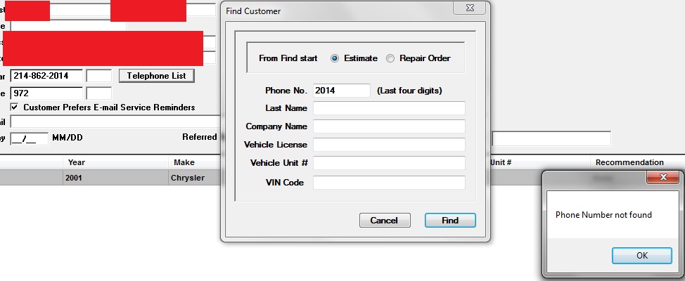

This is what I get when I search. If I understand you correctly, I am entering the phone numbers in the not-so-special expected format. As you can see, I searched for a number that is clearly in my database. And it did not find it.
