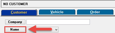

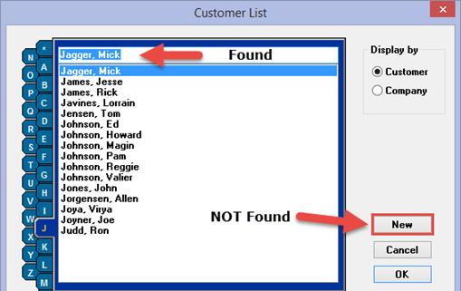

A Counter Sale (basically a simplified Invoice with a flag on some reports) starts by clicking an icon with the presumption that it will be a quick cash sale and to not introduce the overhead of the F6/New steps to such a transaction.
For any Counter Sales that are not CASH and a customer name is to be added, users MUST be trained to use the NAME button as this opens the customer list to verify and select the customer by name. In the event that the customer name is not found, a New button opens the Customer screen for fresh input for a new record to be saved.
