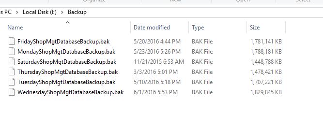

I just looked I'm at just about 1.9 GB maybe?
