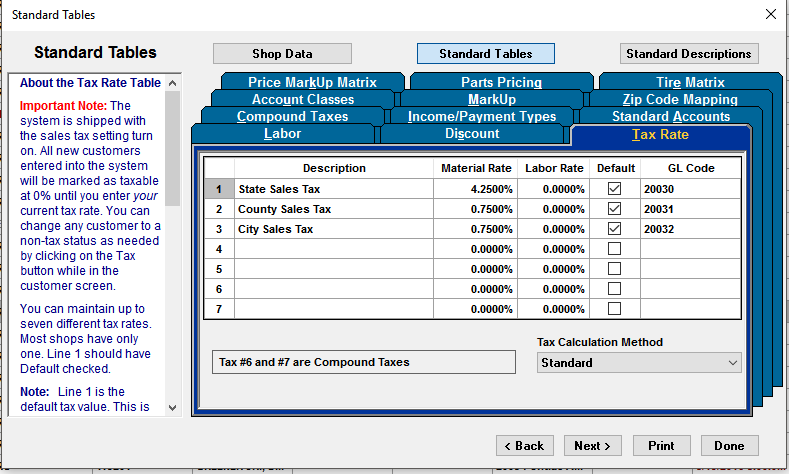

If you setup your three taxes as different rates with different GL codes, they are very easily tracked.
For example. Here are the taxes broken down the same way you're proposing.

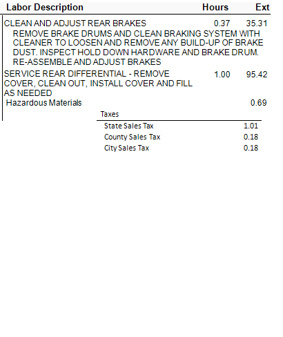

Then I created a dummy invoice, to show how this changes the way invoices will display a new tax breakdown:

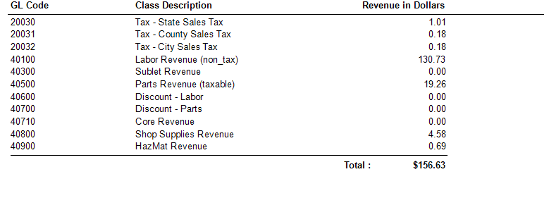

And finally, running the Revenue by GL Code Report at the end, each remittance is quite clear:

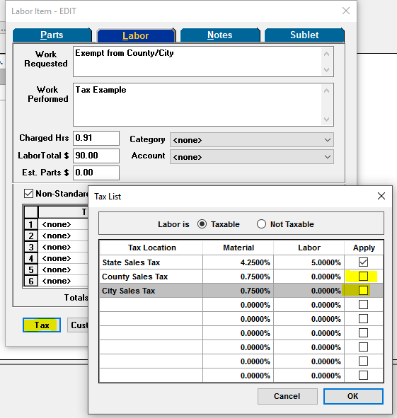

I'm not sure if follow you completely, so I apologize if this isn't relevant, but any given item can be taxed differently from the whole of the order. Sticking again with Paradigm's original topic idea, if we break down State/County/City, then only need to collect State on a given item:

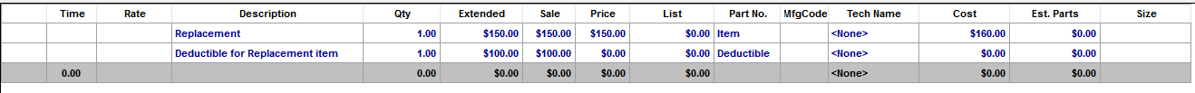

I think Washington has a unique situation because it is by dollar amount and not by item. So...they could have a single item that is $250. However, because they have a $100 deductible only $100 is subject to sales tax. The remaining $150 is not. It is usually even more complicated than that because it is multiple items that are partially subject to sales tax.

There may be a way to work around this, which is probably what you're doing now. Sticking with your example, the first line here is marked as non-taxable, and the second is taxed normally. If I'm misunderstanding this scenario still, could you provide a link to the Washington state tax legislation that explains this?

That is actually how I have been doing it. It is as clean as it can be the way you suggested. It is just never as simple as one item, of course, because the warranty pays an allowed dollar amount on each item - leaving a tax and untaxed portion on most parts and sometimes on labor. http://dor.wa.gov/docs/pubs/specialnoti ... anties.pdf
