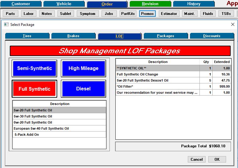

We use to use canned jobs for our oil changes, but we have just went to the LOF packages.
From my experience, its no different then canned jobs, but just groups everything together. It makes for a couple extra clicks, but overall better and easier (I think). I have 12 different oil changes with semi synthetic, high mileage, full synthetic, and diesel. PLUS we have an add on for our 5-pack deal. And as I write this, I think i should have another add on for the BG kits too...
But this has allowed us to track sales of every type of oil. The only thing I have to do is transfer in the correct filter. We have had a couple people sell the package without a filter, so I have added a "Generic Filter" with a cost of $999.99. This reminds everyone to delete it and add the correct filter.
I also have every filter in my inventory and have them price locked at $4.90. So regardless of the cost and the matrix, it sells if for the price I set.... certain premium filters that cost me over $4, I have price locked at their list price.
This way 95% of my oil changes cost 34.99. Once I transfer in a premium filter, it will increase the invoice accordingly. If I change the oil quantity from 5 to 7qts, it also changes the cost and sale price.

Just playing around with the LOF packages, you're right in that they work just like the canned jobs. We just have a parts kit attached to it that prompts for what type of oil to use and a note built in to grab the filter from the parts catalog of our local vendor.tmbutitta wrote:We use to use canned jobs for our oil changes, but we have just went to the LOF packages.
I'm curious though how you handle your 5-pack oil changes. We've got some cards for them, but we're kinda unsure how to implement them.
