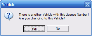

Okay I tried to replicate this as follows:
1. Had a vehicle with a certain plate # on an estimate.
2. Changed the vehicle on that estimate so I could delete the vehicle record WITH plate.
3. Copied the plate # and deleted the vehicle record.
4. Entered a new customer and vehicle; pasted the plate and got this dialog:
5. Answered YES and it brought back that old vehicle record.
6. Deleted the plate # and clicked Exit; Save changes to Vehicle record? YES
7. Returned to entering new vehicle; pasted the plate okay.
8. Sipped coffee, kept going.

Unless I'm missing another detail here, time should not matter. It's what you do when you enter that plate # and get the dialog that does.
Re: Clear Plate #
Ok got ya so then delete it and then reenter all data for new vehicle. But what if you hit no? Thats what we are doing I think. Im now making it a habit to remove plate first.
Re: Clear Plate #
Right; when you answer NO the only option is entering a different plate or leaving blank. If I'd walked through this earlier I could've said so then. :oops:
Good practice to remove plate when deleting vehicle but there is still an option to bring it back up later and pry it off. :idea:

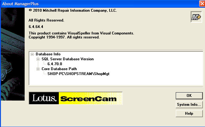

Before I reinstall, thought I better make sure I am right.
The Manager Plus screen shows Version 6.4.64.4 with database version 6.4.70.0
Version screen 1.

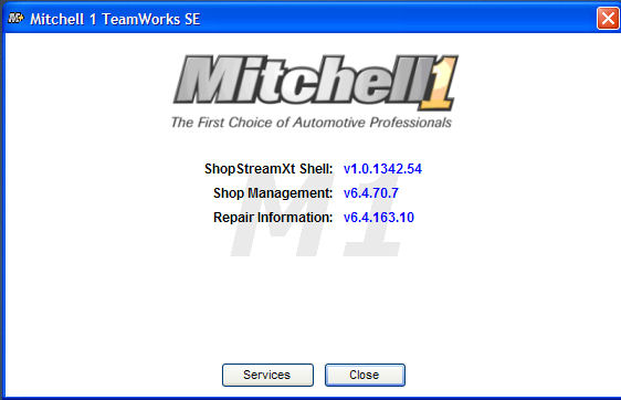

The Mitchell 1 TeamWorks SE screen shows this.

rhillig wrote:Before I reinstall, thought I better make sure I am right.
Those are current; the 6.4.70 database was the main thing to check. It may be necessary to work with support on your concern.
