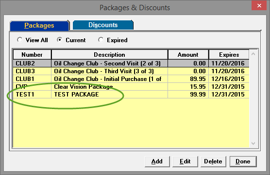

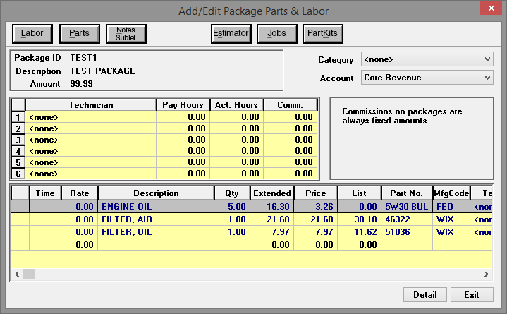

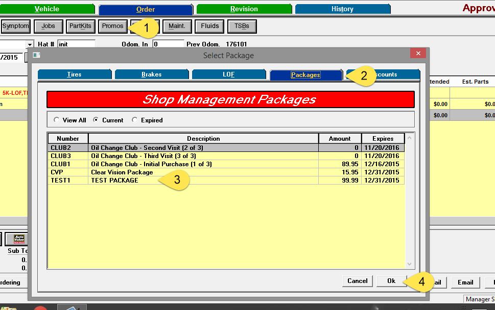

I'll jump in...
You're going to want to use Packages for that. Packages allow for one set price and will allow for parts to be added that will come out of inventory while remaining anonymous regarding pricing. The thing with Packages is you can't add the parts in advance. You add them after the Package is on the RO.
Go to Configurations>Packages and Discounts and add the Package.
Transfer a Package to an RO by going to the Order screen, clicking on Promos>Packages>select correct Package>OK.
Now that it is on the Order, you can now open the package and add whatever you want.
Once you add all your goodies onto the package, you can invoice the order. All that will appear on the Invoice is the Package title and the Package price.

Is there a quick key way to get packages on a work order like the canned jobs?ricmorin wrote:Yes, you can do that. Just figure what your oil change price will be and create the package at that price. Once the package is on the order, you can add whatever you want to it and the price of the package will remain the same.Sauvageaus wrote:For an oil change if you have a set price for 5 qt and stocked oil filter, can you still do a package job and then when you put the oil filter in change the part # of the filter to track the inventory?
- Posts: 5999
Re: Building Canned Job Packages w/o Showing Part Prices?
The button is on the order screen called Promos. Then click Packages, select the correct one and click OK.
