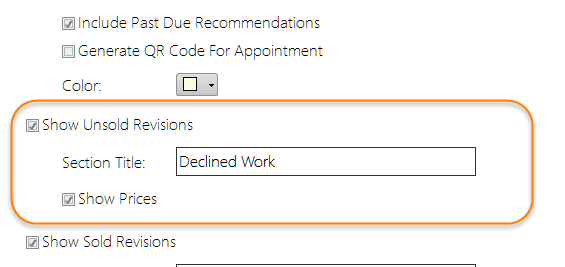

Re: Declining lines without erasing-
You can turn off the declined work feature in the Propack invoice here.....
Post by Pauls Automotive »
Good to know. I actually don't mind it just wasn't sure where it is coming from. Now at least I know I can shuffle the more inportant revisions around so they appear on the bill. Thanks Ric.
