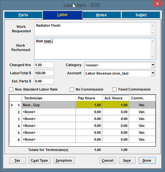

It just looks like you need to alter the Pay hours. Take this simplified case. I set labor to $100/hr even, and the tech to $20/hr.
Note, I charge 1.5 hours, but if it only took him 1 hour, I set his Pay and Actual to that one hour.
2020-03-06 14_45_24-Labor Item - EDIT.png (18.7 KiB) Viewed 8397 times

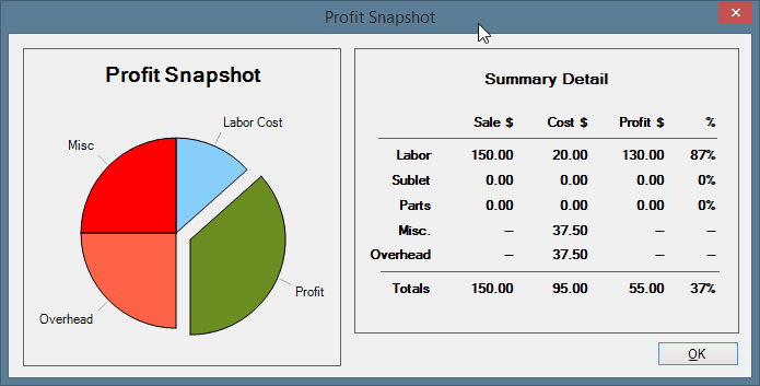

My check profit is correct:
2020-03-06 14_46_29-Profit Snapshot.png (15.46 KiB) Viewed 8397 times
However, if I forget to adjust his Pay/Actual, then he will be paid to match the Charged Hours:
2020-03-06 14_47_02-Profit Snapshot.png (15.42 KiB) Viewed 8397 times
