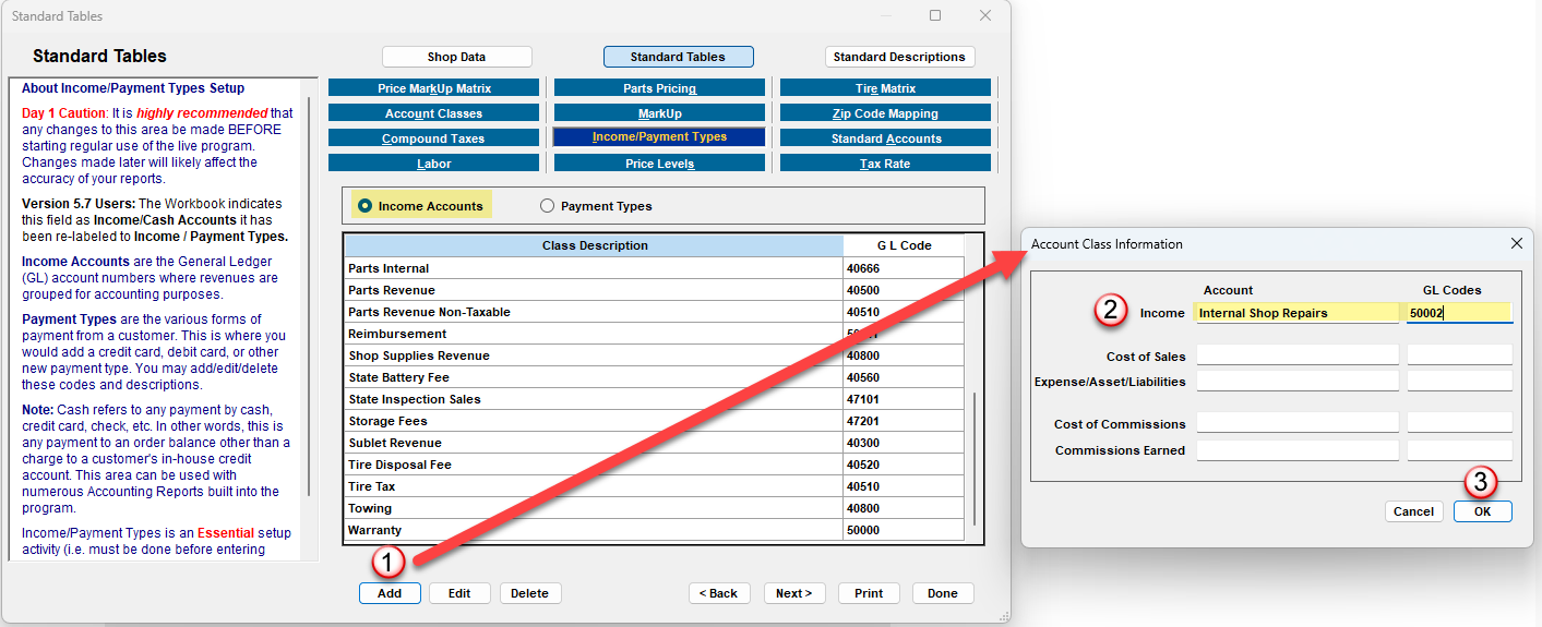

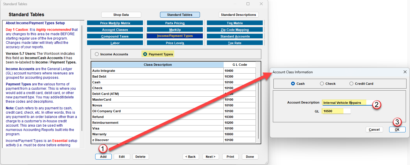

Internal account is funded (at least accounted for) by the shop itself as opposed to standard customer payment types.
It is understood that any report work billed to the internal account will be SUBTRACTED from daily cash receipts.
NOTE: Please confer with your accountant about this before making any changes to ensure you end up where you all agree where you should be on this matter.
1. Internal Account setup
2. Payment Type selector (to apply it)
Internal Income Account.png (110.27 KiB) Viewed 24276 times
Internal Payment Type.png (106.62 KiB) Viewed 24276 times
