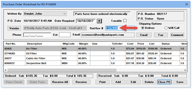

Good practices! You may be aware already but just in case,;when you open your P.O. to receive parts,
you may enter the Vendor invoice # right there and it will be added to all the parts received at once. :wink:
