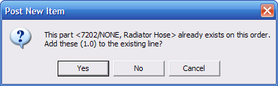

Re: Revision: Parts Already Ordered?
When you add any part number that already exists on an Order or Revision, the program will display a box like this:
If you answer Yes, the quantity will be increased on a single line. If you answer No, it will create another (duplicate) line for that part number.Tim McDonnell -
I had clicked that correctly, and the lines did come up separately on the RO.
I thought at first that they were combined in the parts ordering window, but I was looking at the wrong column.
So, at this point, at least I now know how to individually confirm parts, and hopefully that will help us to keep track of what's ordered and what is not. However, the automated process still doesn't work for me, if I don't go in and manually manipulate that, it will allow me to order the same oil filter indefinitely, without ever coming off my parts ordering list.
