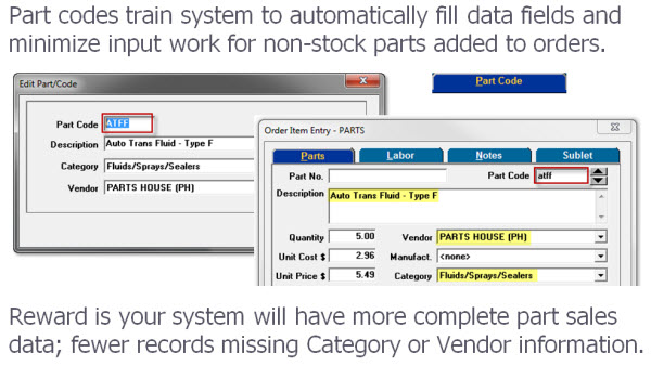

JCADan wrote:Are there any updates on this issue? We use ATF as our part # for bulk transmission fluid and get tired of having to manually put in the vendor each time. We would rather it just be saved with the inventory parts list so that everything comes up when i type in ATF <TAB>
What version are you using? The Part Code feature can auto-fill Category & Vendor fields every time you type ATF. Go to Setup - Standard Descriptions, Part Code tab to edit ATF entry or to add it.
Re: Need "vendor" on inventory parts
crabtree1 wrote:still waiting for a vendor spot on the inventory input for our SE6 without the inventory module
As you already know, Manager has a simpler Parts List in lieu of true Inventory and its provisions including Vendor. While 5.9 and SE may look almost identical on the surface, the SE database design underneath is vastly different, such that without the presence of the Inventory table, there is no way to add Vendor to Manager only database.
