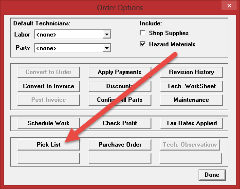

You can link manually created PO's now. Once parts are on an approved repair order, click on Options>Pick List to make the PO. It will be linked to the RO.

You CAN link manual POs to your Repair Orders, it's been available in the software since 1998.
By using the Order Options -> Pick List -> PO workflow the resulting Purchase Order is linked to the RO you started from. Pick List will display outstanding parts needs (subtracting parts on hand) and then the Pick List is converted to PO and transmitted to the vendor by phone, fax, email, IM, whatever. When you click on View POs for the order it will be listed there just as if you had ordered from an electronically connected vendor.
NOTE: Your system should be set to Mark All ROS as Approved / Printed (Setup - Shop Data - Screen View tab checkbox) or you are manually marking the RO as printed to make the parts need visible to Pick List process.
