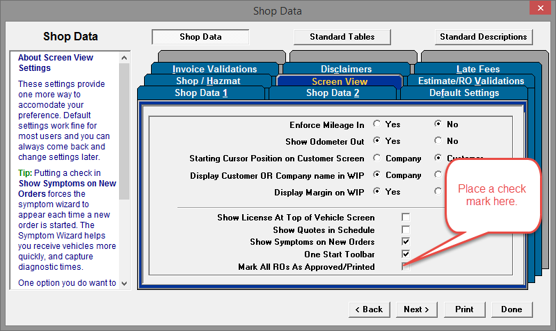

- Posts: 5999
Re: Issue With PO & Committed Parts?
If your process flow does not print an RO for the customer, best to set the program to do it automatically. Go to Setup>ShopData>ScreenView and select the box.
