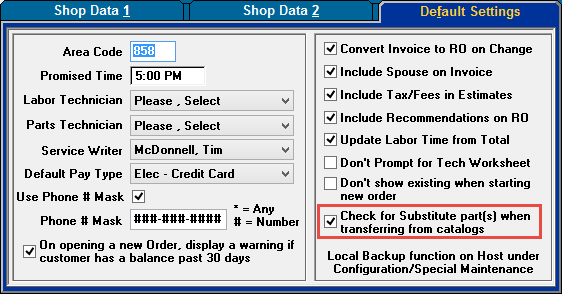

Please know that depending on what kind of relationship you've defined, the rules for Alt part entries can differ from actual part records in your database. The Alt part is an alias for an existing part. To eliminate the issue from changing oil filter lines, I would consider a Supercede for each of these to the new equivalent part you order. That way you show the relationship and if the older number is requested, you get the split screen (old/new #) to select.
Since it wasn't mentioned so far, you might not be aware of this new option in Default Settings in regards to handling parts where there are line code differences:
- subpart.png (13.99 KiB) Viewed 5133 times

When did that option get added for look for other part numbers?
I don't believe that Supercede will work with a catalog import, only if you enter the part number manually.
- Posts: 4540
Re: Supersede/Alt Parts when importing from Napa Prolink
Correct; the Supercede feature would not work with a catalog.
According to our WHAT'S NEW In The Release? link [home screen] we added the Default Setting option during the SE 6.6.8 release.
