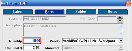

5. Open Part Item Edit - see part record header dimmed indicating an inventory MATCH So far so good; it seems to be working as this thread suggested.

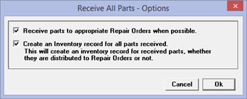

Do you tell the system to "create an inventory part where none exists" or leave that box un-checked? 10a. box unchecked = parts "received" but the part record (part # only + no line code) doesn't update it still says QOH 2
10b. box checked = parts are received to NEW part record (part # + line code) QOH =4 and the existing part record (part # only + no line code) still says QOH 2 Back to the point sale - ask for the same part #

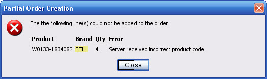

>>> b. Wrong Line Code = warning [fig 1]

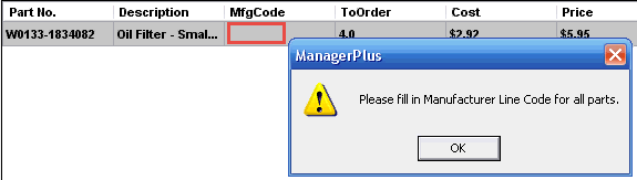

>>> c. Blank Line Code = warning [fig 2] then verify part number while in catalog (then Checkout)

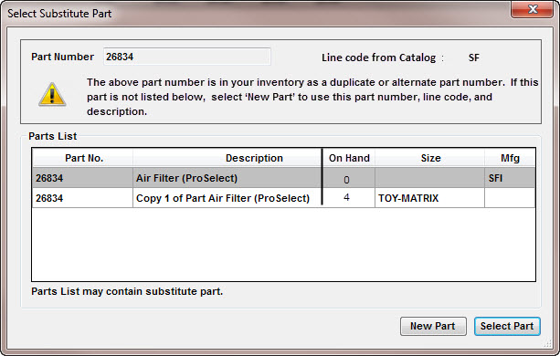

4. Open Worlpac catalog
a. Click on ‘Air Intake’ in left panel
b. Click on ‘Air Filter’ in right most panel
c. Click on Export

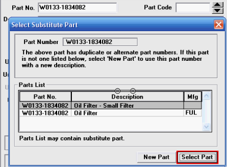

5. ‘Select Substitute Part’ dialog opens.
a. User can select any of the three parts; which also includes the alternate part

• Notice the ‘Select Substitute Part’ is not presented

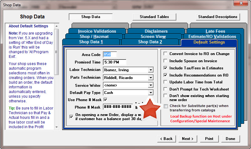

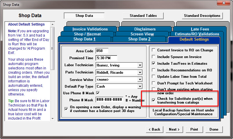

We are looking at something like this to help resolve parts. Please weigh in with comments.

I am not sure why there needs to be an option, why would anyone not want to automatically check for alternate part numbers for the same part when it is imported?
I may be missing something.
Example. I stock a BMW filter that also fits a Volvo. BMW and Volvo obviously have different factory part numbers. But the filter manufacturer has the same part number, because it is the same filter. So when I import the Volvo filter from Worldpac, the number gets connected to the BMW filter. This way I do not waste my time ordering a filter I already have on the shelf.
If the option box is the only way to do it, so be it. As long as it works and does not require any data other than part number to match. If the manufacturer field is needed, then it will not help of course because the manufacturer is often different and we leave it blank.
Does that make sense?

But... how would the user handle the problem of ordering from a catalog that does require a linecode. The system can handle a match coming in because we control that in our application. But resolving it on the catalog end is out of our control. Here is an example that I see as a potential problem:
We need 6 sparks plugs for a vehicle. I open Worldpac / or any catalog, lookup the plugs (no.: DPR9EIX-9 code: NGK) and transfer then. The Select Substitute Part dialog opens because you have the same part number in inventory, it has a different line code(no.: DPR9EIX-9 code: NSP) , the quantity on hand is 4. Manager is smart enough to know you only need to order 2 of the plugs, DPR9EIX-9 code: NSP , because that is what is n ow on the order.
You open the parts ordering window and do a price check/availability with the same vendor you used to look-up DPR9EIX-9 code: NGK. . But you can't order from this vendor because they do not carry: DPR9EIX-9 code: NSP, and have no function in their catalog to ignore line codes? What would be the next step.

Just to be sure - there is no link - it is a match. The software will see the part number is the same as one in inventory and ask do you want to use the one from the catalog, or the one from inventory.
New optional setting - by default turned off. What happens when catalog transfer a part number that matches in inventory:
