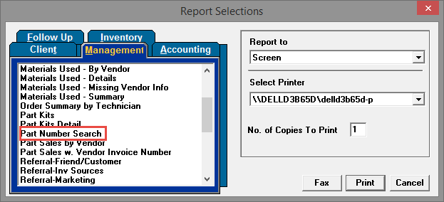

There are a few reports worth mentioning. First is the part number search report. This will tell you all the times a particular number was invoiced within a date range you specify. This found under the management tab......

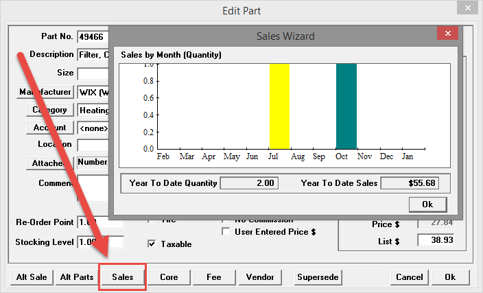

I have a question about that part sales graph. It doesn't specify the current month. For example it shows Feb. - to Jan. If its October and look at parts sales graph, it shows that I have sold this part in December. Am I to assume this graph is Feb. 2016 to October 2016 and then continuing back to Nov. 2015, Dec. 2015, & finally Jan. 2016? Does this makes sense? I figured it would start with the with oct. 2015/current month starting a year ago and going forward into the current month. Any help would be appreciated.
