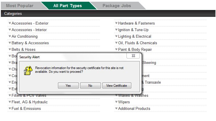

The FirstCall catalog opens the browser window and warns "Warning: revocation information is not available for this site" and then asks if you wish to continue. If you click on details, it mentions something about a GoDaddy certificate issuer. You can click on the OK/Continue button, and you get about 12-15 identical pop-ups in a row. But if you click through them all, then you get the FirstCall site and catalog and it works just fine. You can transfer your parts to an RO, and even order the parts electronically with no problems. After you have gone through that ordeal once, I believe you will not receive that error again until you exit SE and then re-open it. When our Independent Rep encountered this while setting us up, he called tech support who said they'd never seen it before, must be network or computer settings on our end. I told him I would have our IT people get on it. Two weeks later, having exhausted every conceivable update/tweak/setting on both the machine and our SonicWall firewall, they intercepted the web address the catalog was opening, and copied that address directly into Internet Explorer on the same machine and it opened just fine, with no problems/warnings whatsoever! They tell me that SE is in fact using Explorer to open the catalogs, so if it works in regular IE it should be working in the mini-browser within SE unless there is a problem with some library it may be supposed to load?

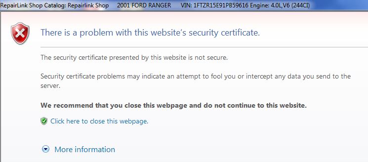

Today, I noticed for the first time that our Rep hadn't set up the RepairLink catalog on the shop machine for some reason, although it was installed and working on my "workstation" (we are still figuring all of this out, just transitioning to electronic R.O's). So, I downloaded the catalog installer, closed out SE and installed the RepairLink catalog. Opened up SE, turned on RepairLink and tried to open it. This time, instead of a pop-up, I just get a full white page with a warning that there is a problem with this site's certificate, and it will not allow me to go any further.

RepairLink Error
RepairLink Error
FirstCall Warning
FirstCall Warning
