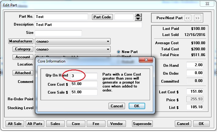

Ok so bare with me here please.. I'm trying to wrap my head around the core system but I'm hoping somebody may have a little insight. Here's what we have so far.
Scenario #1. Part Cost $100, core cost $51. Part is received at the correct cost of $100 via PO (PO does NOT prompt to receive a core). Matrix sets sell price to 185.18 and part is transferred to work order without core (job is in house core will not leave shop). Transferred part now deducts cost of of core from cost of part leaving a cost of $49 with a sell price of 185.18. Sell price is correct cost is incorrect. 73.5% profit = False. This alters revenue report.

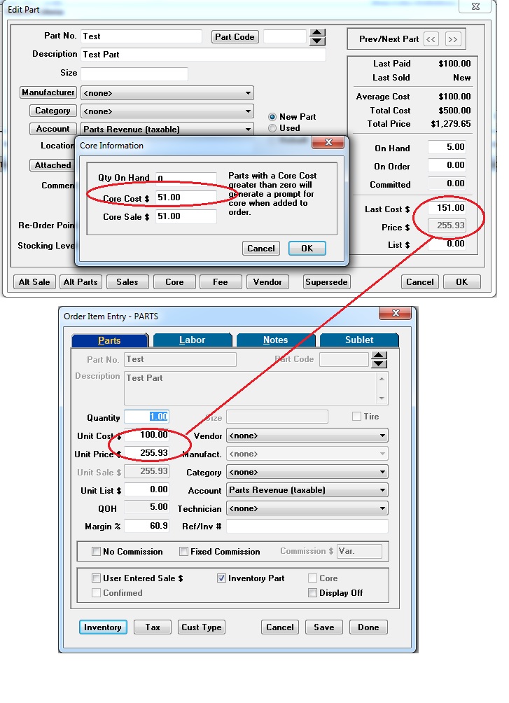

Scenario #2 (as per Mitchell core instructions) - Part cost is 100, core cost is 51. Part and core are manually added together and received via PO as one lump sum of $151. Matrix sets sell price to 255.93 and part is transferred to work order without core (job is in house core will not leave shop). Transferred part now deducts cost of of core from cost of part leaving a cost of $100 with a sell price of 255.93. Sell price is incorrect cost is correct. 60.9% profit = False. This alters revenue report. Customer feels price is way higher then our competitor... sale is lost.
Scenario #3 - Same as #2 except insert a list and customer entered price to over ride the matrix. This works.. except it fully negates having a price matrix and requires manual updates of sell price on all items with a core. It also does not tackle the issue of the false purchase price which is on record.
Now for the actual cost tracking.. because parts are being received at a false rate this is now inflating what we have spent with a specific supplier. Ordinarily this would be resolved once the cores are returned, however after multiple phones calls to tech support, sifting through videos and tutorials I can find no way of reconciling the cores I have on hand. Each time I add a part w/o core to a work order, my core count climbs. How do I show these cores have been returned to their respective supplier and that money has been refunded to me? The idea of an infinitely rising core count seems particularly goofy. Simply deleting a core out of the count does not reconcile the costing side of things throwing a false report again.
Can anybody shed some light? Am I missing a setting or a different area of the core system to make this functional?

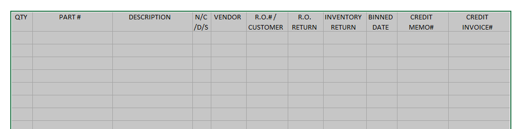

We have a tracking sheet that follows the return process, core, defective or new, from beginning to end.
All returned parts are tracked here.

ricmorin wrote:We have a tracking sheet that follows the return process, core, defective or new, from beginning to end.
Thank you. I thought it was way too complicated through Mitchel 1 and it would take a lot of effort to make the taxes, etc work.
Re: CORES?
You're welcome. I can send you a copy of the file template if you want.
