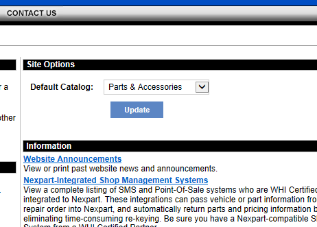

Nah, Nexpart shows without issue, it's the catalogs inside of Nexpart that I'm having an issue with. AutoZone, AP, FMP, all have a new, "Enhanced" catalog. On our host PC, the enhanced catalog is default. On my workstation however, I'm stuck using the old catalog, which is missing a bunch of features the enhanced has. I've got all the settings between the 2 the same, but nothing will bring up the enhanced catalog.
Re: Secondary Workstation Won't Turn On Nexpart Catalog?
Let's make sure we've got the settings right. When Nexpart is open, you click on tools, then down on the right there is a drop down list. You have the Parts and Accessories selected and NOT the Classic Catalog?
After selecting, close out and see if the setting sticks.

Under Tools, the default catalog shows "Enhanced", "OE Collision", "OE Mechanical Parts", & "FMP Non-app Catalog". I'll run the update and see if that works it out. Thanx!
EDIT - Running the update worked!!! SCREAMIN'!!!
