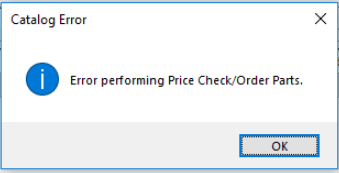

I've been working recently to get our inventory in order and be able to restock as needed. last week I finally got ready to try restocking. when I use the Restock From Inventory button on the P.O. screen and try to price check, it pops up an error window and will not let it place an order. I spent a couple hours Friday afternoon with Mitchell tech assistance and my IT people and was unable to rectify the issue. towards the end of my last call to Mitchell, there was mention made of an issue between Repairlink and Manager SE. Just wondering if anyone has had any issues with this and any luck fixing it?

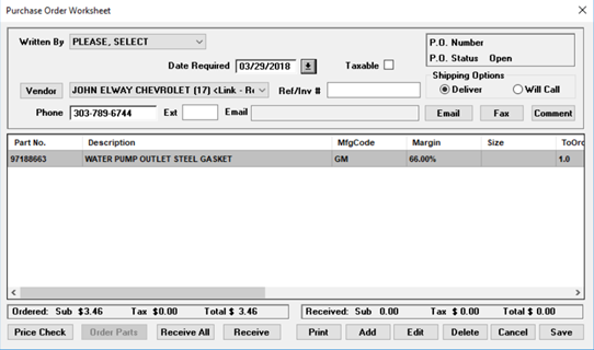

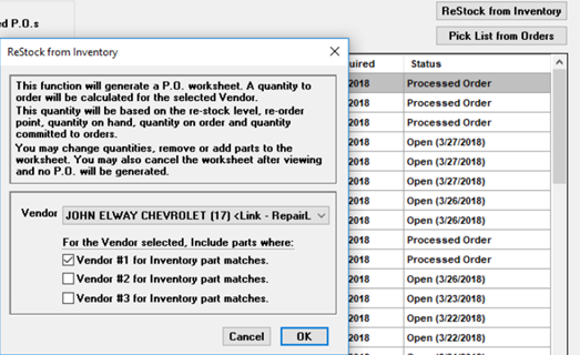

here are the screen shots that seem relevant, I can get more if there is anything you think will be helpful.
