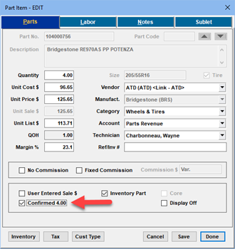

It doesn't matter how they are applied to an order; it works the same both ways.
Once they (tires) land on the R.O., double-click on the tire line (or highlight it and press Enter) to gain access to Part Item Edit window to check the Confirmed box and Done.

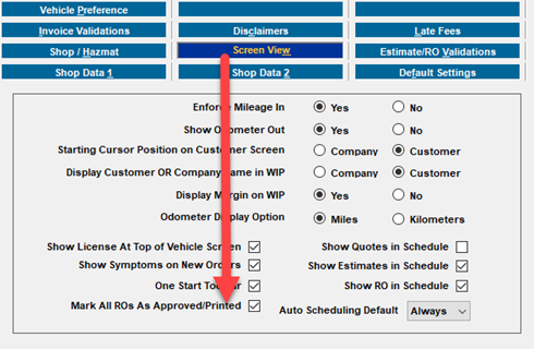

Confirmed would be dimmed for a) Estimate and b) R.O. not marked as printed. <<< That commits the tire; then the Confirmed checkbox is available. NOTE: If you don't want to manually mark your Repair Orders as printed, use the Screen View tab option to automatically Mark All R.O.s as Approved/Printed.
