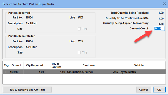

As far as ordering and receiving catalog parts, I believe you're first made aware of cost differences when ordering, without seeing the inventory record, you'd not notice anything different at that time. However, there is an opportunity to update the part cost during the item receive process. As you receive a part, you'd look at the cost on vendor's invoice and compare it to the cost shown in the Receive and Confirm window below. If the cost is different, you'd enter it then and there to update your inventory record.

Re: Non-Inventory Parts Tracking
At the risk of sounding completely stupid after using Manager SE for the past 15 years, I have never seen that particular screen shot when receiving parts....
What am I missing here???
Samejhenry wrote:At the risk of sounding completely stupid after using Manager SE for the past 15 years, I have never seen that particular screen shot when receiving parts....
When you go into the POs and select one and double click it , it will open up a receive part to invoice or inventory screen. When you choose to receive it to either it will open up the parts window where you can double check the price and quantity before reviewing it.
