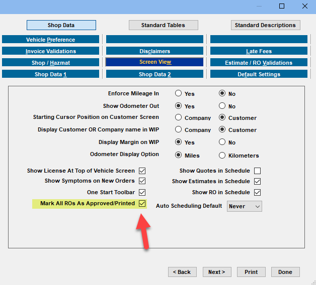

Good. If you haven't already done so you can mark ROs as Approved/Printed with this setting:
Added a 'Committed' indication is not necessary because this already confers that status. ;)
