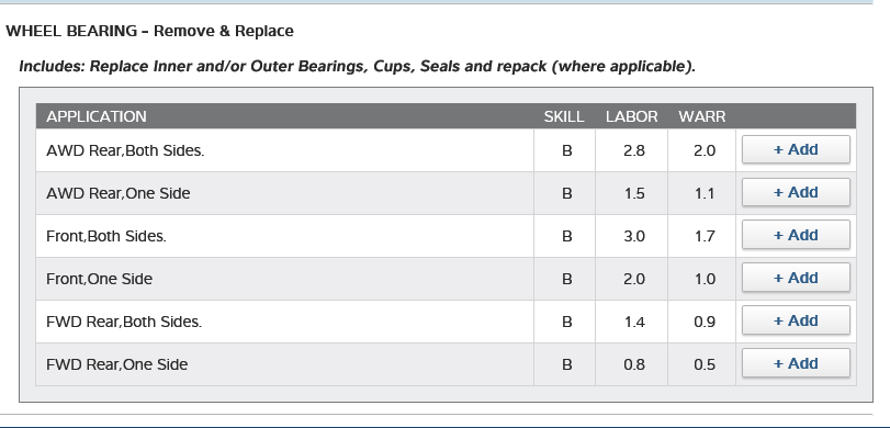

Got a 2011 Kia Sportage VIN KNDPBCA28B7036880 that is an AWD. Rear wheel bearing is pressed in on an AWD. It's a hub assembly if it's FWD. Mitchell shows .8 hours and mentions nothing about an AWD. This is wrong. Another resource we have shows FWD or AWD and AWD is listed at 2.5 hours.
Re: 2011 Kia Sportage Rear Wheel Bearing Labor Time
I put in your vin, did a search for wheel bearing and got this.

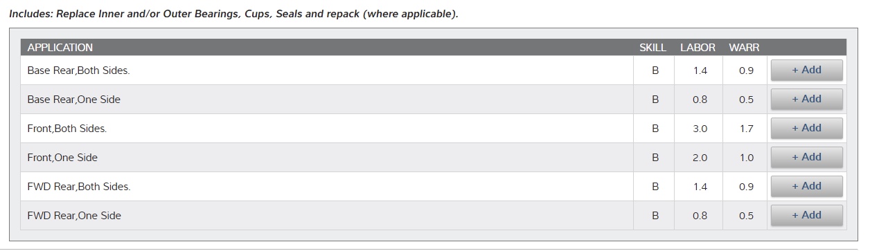

This is what I have and the VIN has been decoded.
- Bearing.jpg (83.5 KiB) Viewed 15439 times
Can you list the exact steps you've taken to get to your example after decoding?

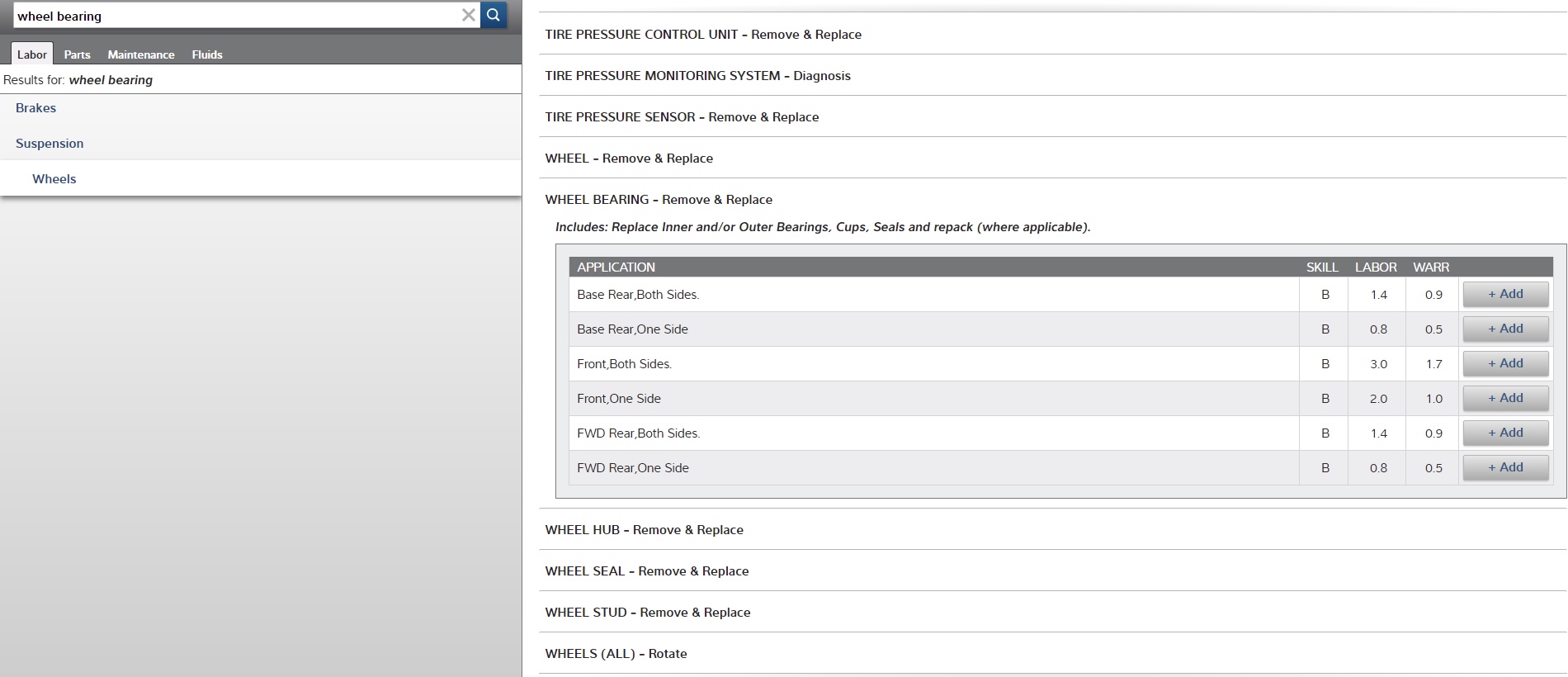

I search for "wheel bearing" then click on "wheels".
This is using Manager 8.0.3.
- bearing (2).jpg (203.64 KiB) Viewed 15436 times
For clarification, are going through Estimator in Manager or looking into ProDemand natively? I tried it both ways and I still get AWD choices. I cannot immediately explain why you are getting a different display than I.
I'm going through manager
I tried that way too. Same result. I would contact support if you feel the need. It's definitely in there correctly; not sure why you can't see it.
Morning Guys,
I noticed when I selected the Sportage LX, I see the options for AWD. When I choose the base model, I don't see the option.
Back in the vehicle tab, remove the last character in the VIN and put it back in, decode and select the LX model.
Hope this helps
Yep you are correct. When I decoded this both options popped up and I looked at the vehicle and no LX emblems are on it so I went with the base model. I just decoded the VIN on decode this and it comes up as an LX.LazyTurtle wrote:Morning Guys,
Hope this helps
Now the next question is my other resource gave me 2.5 and Mitchell gave me 1.5. The customer OK'd it at 2.5. I'm gonna feel guilty if I don't lower it to the 1.5 because that's what I would have went with had I decoded it correctly.
