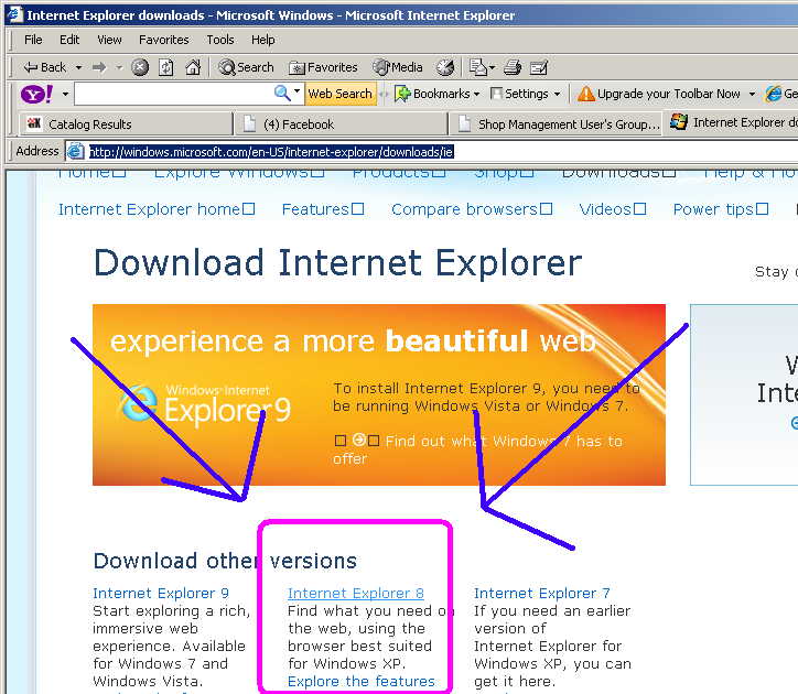

Re: Poor Wiring Diagram Printing Quality?
- ie8.jpg (75.13 KiB) Viewed 24659 times
Thanks for that link Tina,
Windows 7 is not listed so should I download the XP 64 bit version?
If you know you have a 64 bit PC, yes.
If unsure, confirm with this info: http://windows.microsoft.com/en-US/wind ... -or-64-bit
Great Tim. Thanks.
Now I tried that idea and when I launch the installer it says "Internet Explorer 8 is not supported on this operating system"
Anyone have any other ideas?
