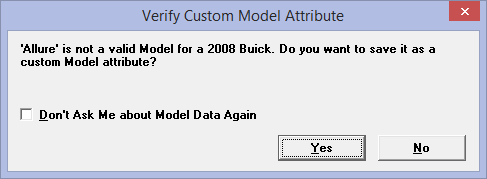

1. Manually enter VIN (no Decode) and 2008 Buick Allure, answer yes to the Custom vehicle prompt. This will record the YMM but repair will always ask for engine and trim (CX or CXL) EVERY time.

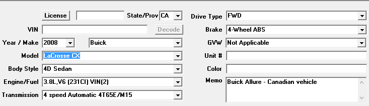

2. Manually enter VIN (no Decode) and 2008 Buick LaCrosse (with appropriate trim level), select Engine. (in Vehicle memo add a note as shown) This will allow you to get all repair information without engine / trim questions every time.
