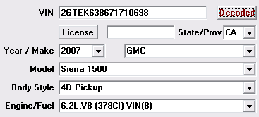

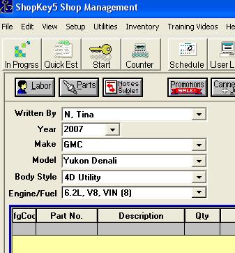

Two things about this one:
In Manager 5.9 the drop list includes this: In Manager 6.4 SE that VIN decodes as follows: Denali is a Yukon body style....

Actually it does; please note that a Sierra 1500 and a Sierra Classic 1500 are two DIFFERENT vehicles. I love explaining GM's goofiness in certain years. 2007 was a transition and you have to be extra careful:

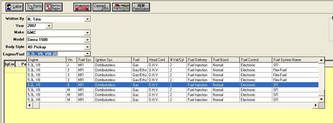

mine only shows 6.2 for the denali
now the 6.2 is there for the pick up, you have to scroll down the engine size to the bottom, it is in between a bunch of 5.3's
i am running same version as you.
