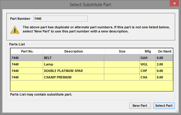

I have part number 7440 in my system 4 times. They all have different line codes. When I add this part using Manager, I am asked by dialog window which one I want. When I add this part using MM, I get the first part in line without reference to the other three.

Ric,
Thanks for that, I now understand.
But why enter the same part number four times to represent four different parts? That seems to be were the issue starts.
My method would be to add another digit to the number. Looking at your example BELT would be G7440, lamp - W7440.....[Second thought BELT would be B7440, lamp L7440]
Approximately how many duplicate part numbers do you have?
Seeing that the Mitchell screen, that you pictured, pops up asking about the a duplicate part number, I figure that their may be a common issue with this.
I'll in put it with the cursor request too.
Because of the extra window, I think that this will require some reasonable programming. I don't know.

Re: Part Number Handling
John,
These parts represent 4 different items. In order to get these from their respective vendors electronically the part numbers must be exact, as does the line code. Changing the part number is not an option. Mobile Manager should be able to handle this like Manager SE does.
