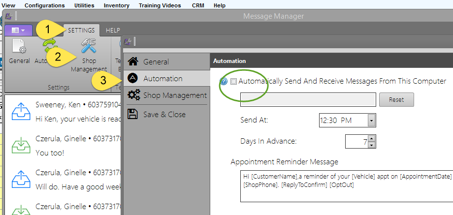

Where would I do this? I looked in settings on Message Manager, and could not find where to assign a workstation.
Also, if only one workstation is assigned to send and receive messages, will that literally mean that only one workstation will be able to send and receive messages?
John C.
Re: Customer Texts Duplicated In Message Manager?
John,
You will find the automatic setting as shown below.
Go to Settings>Automation. Make sure that only one workstation has a check in the green circle as illustrated. This only applies to automated messaging. It has no bearing on manual messages.

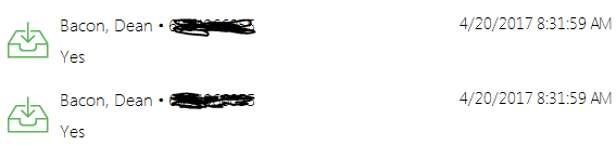

Thank you!
Here is an example of the duplication. I have several more in the log.
duplicates
duplicates
Auto Repair Coach wrote:Ric Morin,
Please let me know if it is the case that more than one computer has been assigned to get and give the messages.
Thanks
No sir. None of the computers are set for automatic. We are not using that feature. Last instance of duplication was 4/20. Has been good since then.
