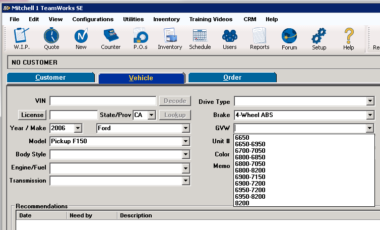

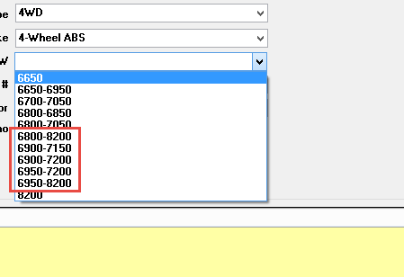

I have been noticing that many GVWR choices have been ranges. I'm fine with that and like to use one of the drop-down choices provided, but many times there's more than one correct choice. In the example below, my vehicle was a 7200 GVWR and there are four choices that fall into that category. Which one do I pick? For now I'm just manually entering the number, but curious why it's displayed this way.
GVWR Choices

I have noticed that for a long time so I manually enter the correct one

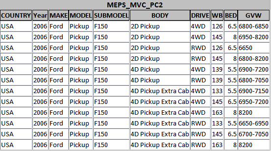

Here's the background that tells the story:
"The 2015 Ford F150 King Ranch VIN decodes to a single GVW range: 6250-8000. I did find the following, which probably exemplifies what you’re referring to: Here is what our 2006 Ford Pickup F150 MVCs – with wheelbase and bed length visible – look like: You can see that the GVW ranges above are fairly specific to a combination of MVC attributes. Depending on vehicle selection and mappings, there could be overlap in what the end-user sees. But, the GVW ranges aren’t necessarily incorrect. And, more often than not, our editorial data is not qualified to the level of GVW."
