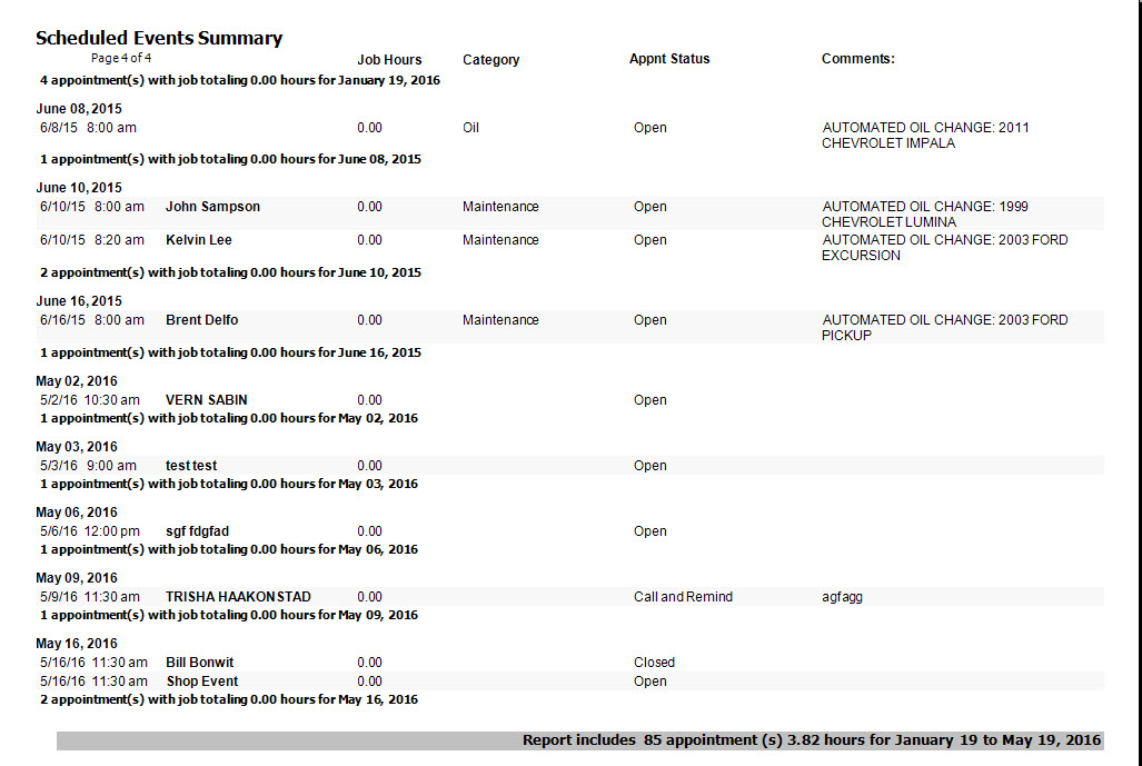

How about something like this?

Just looking for today's schedule printed one line per vehicle/job, otherwise your printout looks like it may work.

Johnny5 wrote:How about something like this?
Just to elaborate...
We would just be looking for a report for a single day (therefore "date" could be dropped from the line item since date would be in the header), customer name, vehicle, category & comments.
Again, this would be one line as you have it for each job for the day.

Thank you for your efforts and the new/enhanced reports. What's the LOE on making them portrait vs. landscape or is this something we can do on our own?
Re: Printing Schedule?
I would have to change it to portrait. Converting to that format would require a much smaller font.
Posts: 489
Johnny5 wrote:I would have to change it to portrait. Converting to that format would require a much smaller font.
Currently, we use the Scheduled Events Report however there's some hoop jumping in that we need to: set the date, click print, click properties, click finishing, select "2" from the pages per sheet, click OK, change the number of copies then click OK. The report is fine albeit a bit more info than is needed. Ideally we would prefer to use the Scheduled Events Summary report if it were in Portrait. To compensate for reducing the font size the following fields could be dropped from the report: Order Hours, Job Hours, Category, and Appt Status. In addition, the date is bold but under that on each line is dated...this date could be dropped as well, just leave the date in bold. If the job hours is opened for user input at some point it would be nice to have that added to the report.
I realize this may be specific to our shop but it would be helpful.
