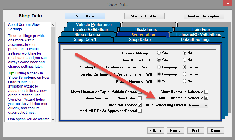

You can turn that off in your setup. See the pic below.....aasinc wrote:Why do estimates appear on the scheduler? We are very unhappy with what Mitchell has done with the scheduler, to the point of finding a new shop management system!

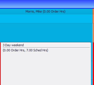

Figured I'd chime in with another issue I run into. So I stopped by the shop today (Sunday) to finish up some paper work and I figured I'd go ahead and look at the schedule for Monday. We had a car towed in late Friday afternoon and I'd like to put it on the schedule for Monday morning and block off about 3 hours for it. However, if I put it on Monday, the customer will get a text message from us due to message manager pro sending out reminders.
The same also happens with a customer who came in Thursday, dropped off, and after getting the car looked at, we find he needs a strut. So I have his original appointment on Thursday, but we will be replacing the strut on Monday. Question is, do I drag and drop the appointment on Monday and adjust for estimated time? Also, anyone have tips on these customers not receiving reminder texts for appointments when their car is already here? I realize this is probably more an issue with how I manage MMP, but hopefully someone has some tips/tricks/ideas.
Even it there was someway to just create a block that was a 'note' containing info like 'strut on the highlander and no start/crank lexus' that I could block off about 5 hours of time with. With my 2 techs working, I try to only schedule about 8 hours of work per day, since I know oil changes will turn into brake jobs, filters, wipers, bulbs, etc. Where I'm struggling is how to handle the oil change I had 1 hour scheduled for that turns into a 4 hour job and how to represent that on the schedule. Even trickier if the parts are special order and we push the job to the next day

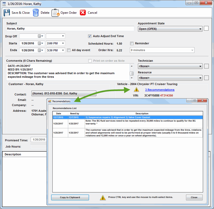

Re: SE 7.0 Scheduler Workflow
Working showing recommendations from appointment editor

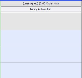

Hey All:) I'm back to beat a dead horse...but I feel it needs beating....
When will we be able to enter in recurring appointments? And when will we be able to right click and highlight a time for a Shop Event on a particular day instead of having it default to the current date/time? Both of these issues would be greatly appreciated for both the service writers as well as the technicians.
Currently I'm having to use Outlook for any recurring appointments or shop events, and Scheduler just takes entire too long to try and set up weekly events or shop events, and then I HOPE I don't double book myself.
We are doubling our size next month and I would REALLY like to get everyone on a single calendar.
Thanks!

- This is what happens when choosing "all day event" Very hard to distinguish
- All day event.JPG (16.28 KiB) Viewed 12183 times
- This is what would be helpful/useful for blocked appointments.
- Block time.JPG (16.99 KiB) Viewed 12183 times

- Posts: 4540
Re: Scheduler Feedback & Requests
We combed all of the input in this area for the last 14 months to determine the main stories to address for 7.1.7 to deliver and there are additional Schedule stories to be delivered in a few weeks with 7.2.x:
•Schedule Window now includes a Help button on each screen
•Appointment State colors are now editable
•Appointment editor to alert when 'seeing' recommendations
•Printing Reports with schedule open, will now maintain focus and leave Manager in the Foreground
•The Source of the invoice is now maintained in schedule, WIP, and order
•Scheduler will now remember what the user selected to Show/Hide while in the schedule screen
•Editing appointments with an order open caused customer information to be switched (FIXED)
•Improved Schedule Appointment Tab Usability
We know that there are certainly some additional concerns and some of these are written up as development stories to tackle as resources permit. Getting these two releases (7.1.7 and 7.2) out there and gaining user feedback will determine the next steps.
