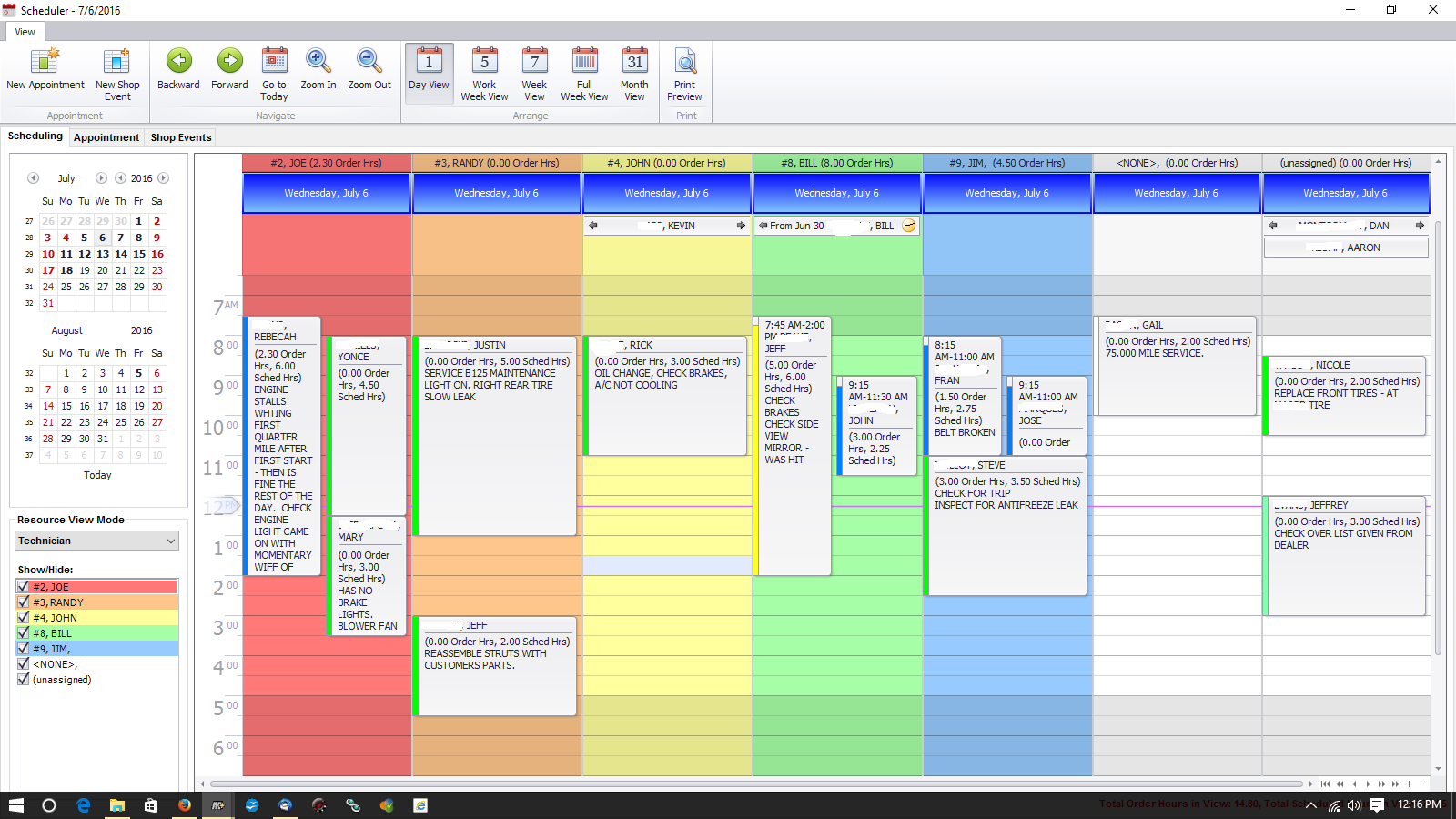

I've been following the discussions here with great interest. We have moved into Version 7 so we could take advantage of the features in the new scheduler. While there is some reluctance and the phrase "why can't it be the way it used to be" is uttered from time to time by the people here who hate change, I can tell you that the other service writer and I have made some adjustments to our work flow that have made it a very nice part of our daily work flow.
I've taken a couple of screen shots that show how we use the new scheduler. Most of our work is done from the Technician view. I have each technician color coded, and two additional columns labeled "None" and "unassigned". I use those last two as place holders for all incoming appointments. As they come in, I adjust the size of the appointments to view the work scheduled, and pay less attention to the amount of hours used. For us, hours are fluid - a simple oil change can expand until a service that can last 4 hours. While another one will only be 30 minutes. See the screen shot labeled "Start Of Day.pdf" As the vehicles arrive, we assign the work to various technicians based on their skill levels and expertise. After they are assigned and they start work on the first vehicle, we assign the 2nd vehicle to their slot. as the time is used, we would adjust the work to show what's actually happening in the shop. As work progresses and technician load becomes heavier for one and lighter for another, we would adjust based on the remaining availability and expertise. If something happens where a technician suddenly becomes unavailable, we can contact the customer and let them know their vehicle will need to be held over or rescheduled. See the screen shot labeled "Daily Process.pdf" Any work that leaks into the next morning is put under that technicians schedule for the following day based on a "best guess" of time left to finish the job.
This obviously wont work for everyone, but it allows us to really plan the day as the day goes along and to react to issues and problems as they arise. Maybe this can help someone else who is having issues adjusting to the new Scheduler.

Thank you very much for these creative real-world examples you've shared to improve the current user experience.JimQuesta wrote:Good afternoon everyone,

This certainly looks great. Our issue is once order hours show up and the availability re-adjusts our calendar turns into a convoluted mess of text abbreviations. Thanks for the input, though. It helps to see those enjoying the new scheduler from time to time.JimQuesta wrote:Good afternoon everyone,
