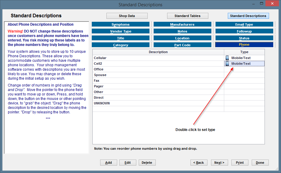

Texting should attempt to use the first (in order) phone number set for display AND marked as text capable. That might be the piece you don't have set. Check your Phone setup types under the Standard Descriptions to indicate they are set a enabled for texts:
We are not seeing an issue with texting in general. The issue is the order. If there are (2) numbers in the contact list and one of those numbers is checked one would assume the checked number is the default for texting...unless texting is not "aware" of the check box in the Telephone List.
I did review Mobile/Text in Standard Descriptions and Cel2 was not set to Text. It has now been set. Does this now mean if we have two numbers that are set for texting and the 2nd one is checked in the Telephone List then the 2nd will be the default when texting?
The rule is the first number - speaking in terms of list order - that is designated as text capable and set to display will be the default when texting.
