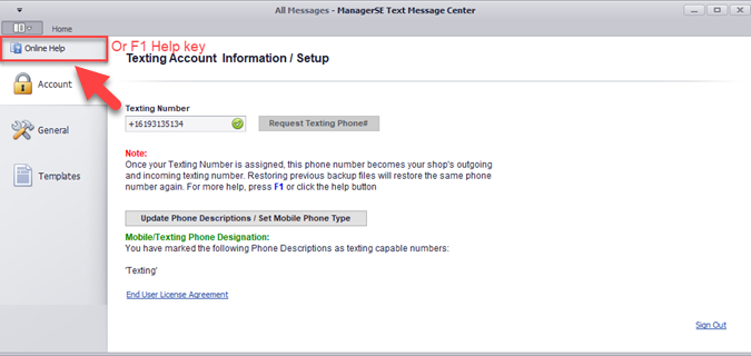

Pressing F1 key or clicking Help button here will launch an SE Help page for Texting configuration: https://www.buymitchell1.net/managerhelp/TextSetup.htm

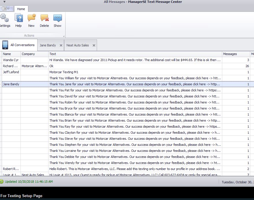

Ric, do you mind sharing what you have worded for the text you send to customers to give you a review?
- Posts: 5998
Re: SE Help For Texting Setup Page
CRM sends those out automatically. If you look at the image I posted you can see the wording and a link for the review. I'm not sure if this is adjustable on Mitchell side.sbebenelli wrote:Ric, do you mind sharing what you have worded for the text you send to customers to give you a review?
- Posts: 755
- Location: Iowa
OK. Do they send it every time a customer is at your shop even if the customer has already received one in the past?
- Posts: 5998
I don't know the details on that, but I can say that yesterday I finished work on three of my loaner cars and I got 3 texts; one for each. This is brand new and I'm sure there will be some tweaking along the way as we discover these little wrinkles.
