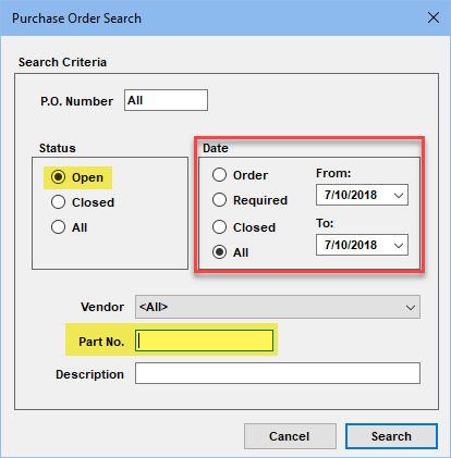

The Part Number Search report only shows results from Posted Invoices. I'd be interested in a way to perform a Part Number Search on Repair Orders and Estimates. Any ideas?
Re: Search for RO containing Part No.?
If your parts were ordered electronically (or manually by Pick List process) you can click on the P.O.s icon up top, it's defaulted to Open P.O.s. Click Search at the bottom of that P.O. list window and enter the P/N in the Part No. field. Make sure to set a reasonable date range:dtstire wrote:The Part Number Search report only shows results from Posted Invoices. I'd be interested in a way to perform a Part Number Search on Repair Orders and Estimates. Any ideas?
