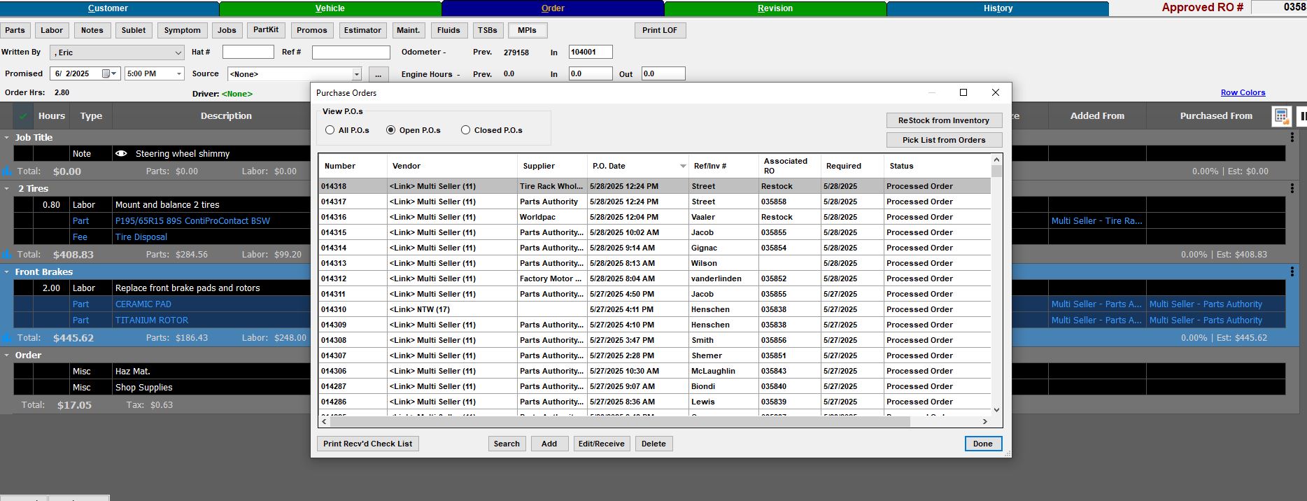

Ok. Here are some tires we ordered today. You can see that they do not turn blue when ordered. And do not show up in the POs from the Order screen. But do show up in the list of all POs. You can see the PO directly below ref Street it was ordered from the same Repair order. Not sure why it says "Restock"?

Thanks for the additional information on this one. We're making progress I think.
A followup question on this if you or the SA that placed the order recall - were those brake pads and tires ordered in the same transaction? I see from the time stamps there were at least very close, but there might be an issue where the second order returned from the vendor (due to different suppliers) is not associated to the repair order.

On that particular order they were all ordered at the same time. And the order did go through to both places. But it acts the same way if the tires are ordered independently.

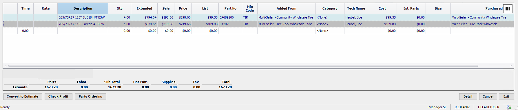

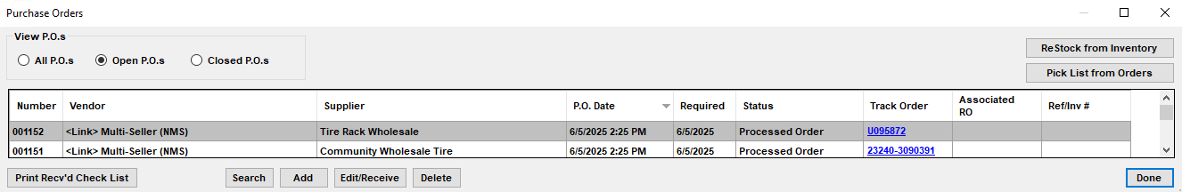

Thanks for raising this concern regarding Nexpart Tire and the PO Number not turning blue or being returned when the Tires are transferred into Mitchell. These issues have been resolved. Please see the attached screenshots of a completed order as a reference.

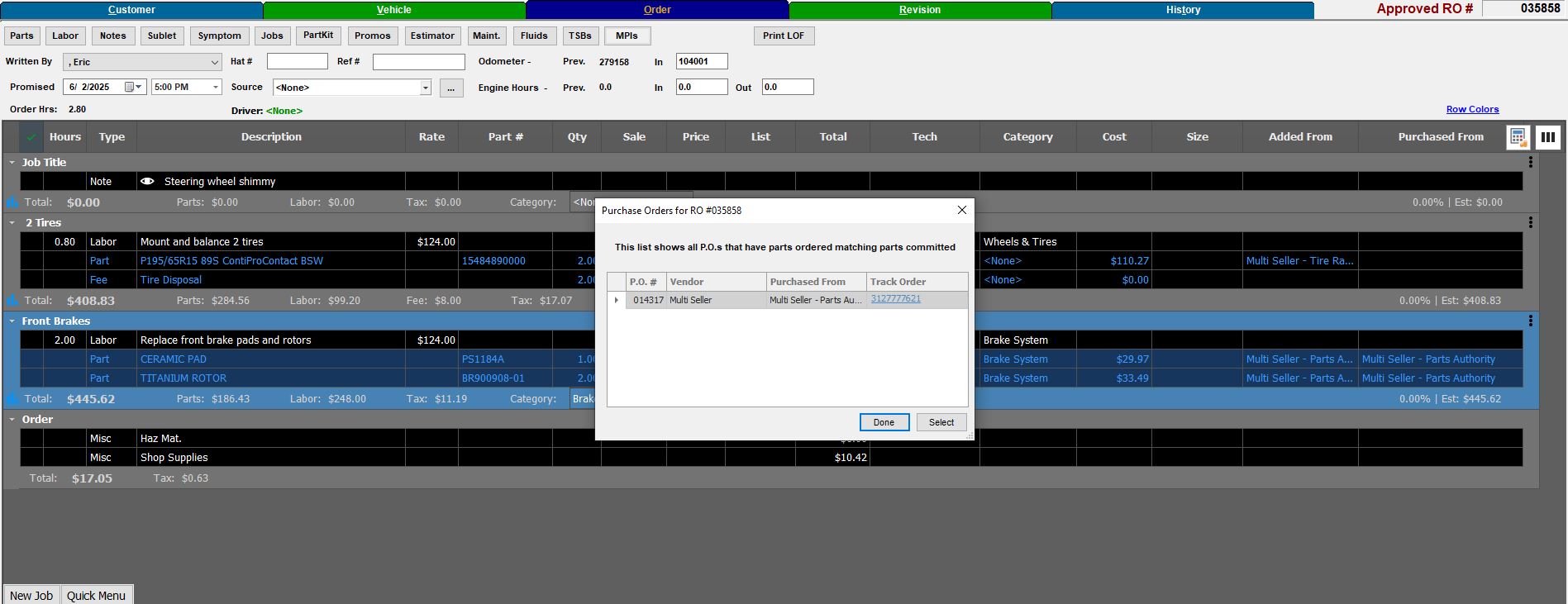

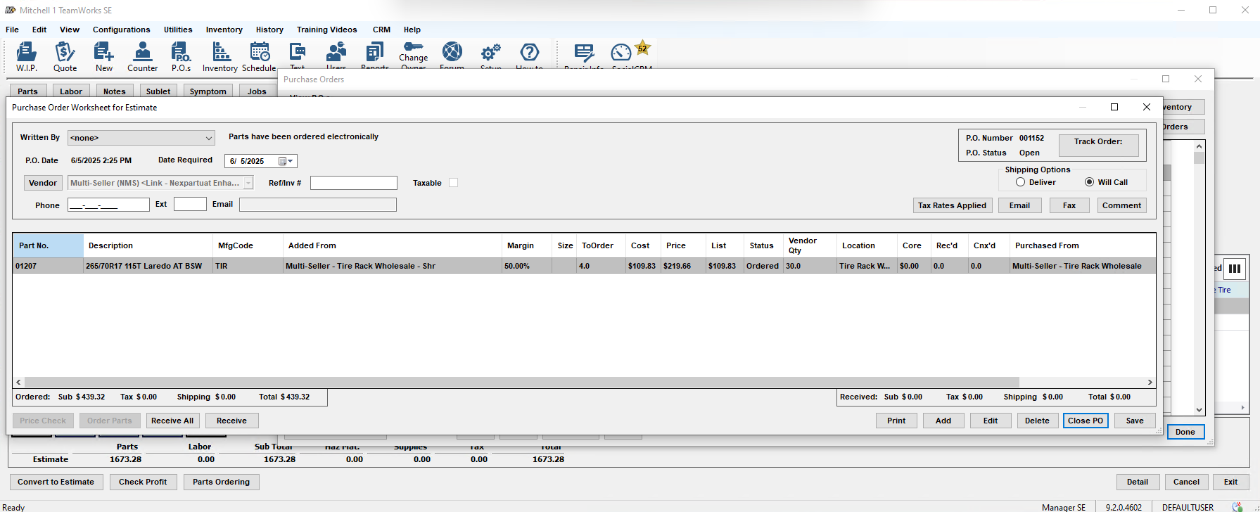

We’d like to take a moment to clarify the order process and address a few common questions for our Nexpart Tire user community
Nexpart Tire is offered exclusively through Nexpart Multi-Seller.
If you locate tires within Multi-Seller and transfer them into Mitchell, a Price Check will redirect you back to the Multi-Seller cart to complete the order.
Once the order is placed through Multi-Seller, the purchase orders will be submitted individually to all Part and Tire Sellers included within the Cart.
Both parts and tires can then be transferred back into Mitchell as part of the completed order.

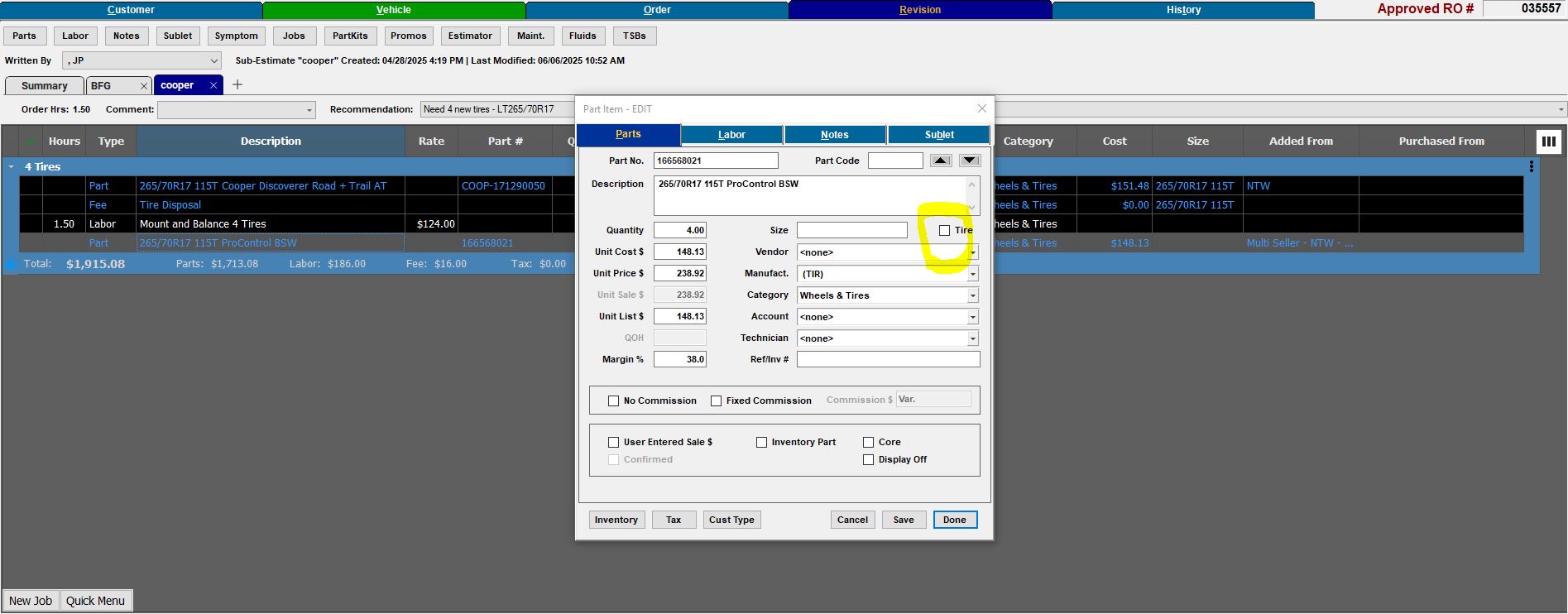

Separate issue related to Nexpart Tires. I spoke to someone there about it but will share the screen shot here also. When we transfer tires to Manager it does not categorize them as a tire. The circled box should be checked so that the system applies the tire pricing matrix and adds disposal fees.

Good News: Our Nexpart development team was already aware of these two issues and working towards a resolution.
1) Can we pass the Tire Size (in the comments)
2) Can we pass anything that identifies the "type" as a Tire not part.
They are reviewing the integration specs and we should have an answer back soon. I'll post with an update as soon as i learn more.
THANKS for the feedback and Thanks for being the best part of Nexpart!
