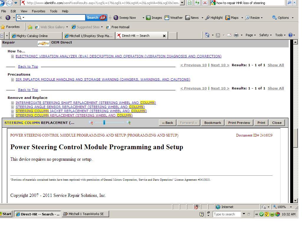

I did find this:
Power Steering Control Module Programming and Setup
This device requires no programming or setup.
Re: 2011 Chev HHR - Electronic Steering
Ya it doenst need it Thanks for looking. Just wild they would recall it in canada and cobalts with the same # part but not these.
