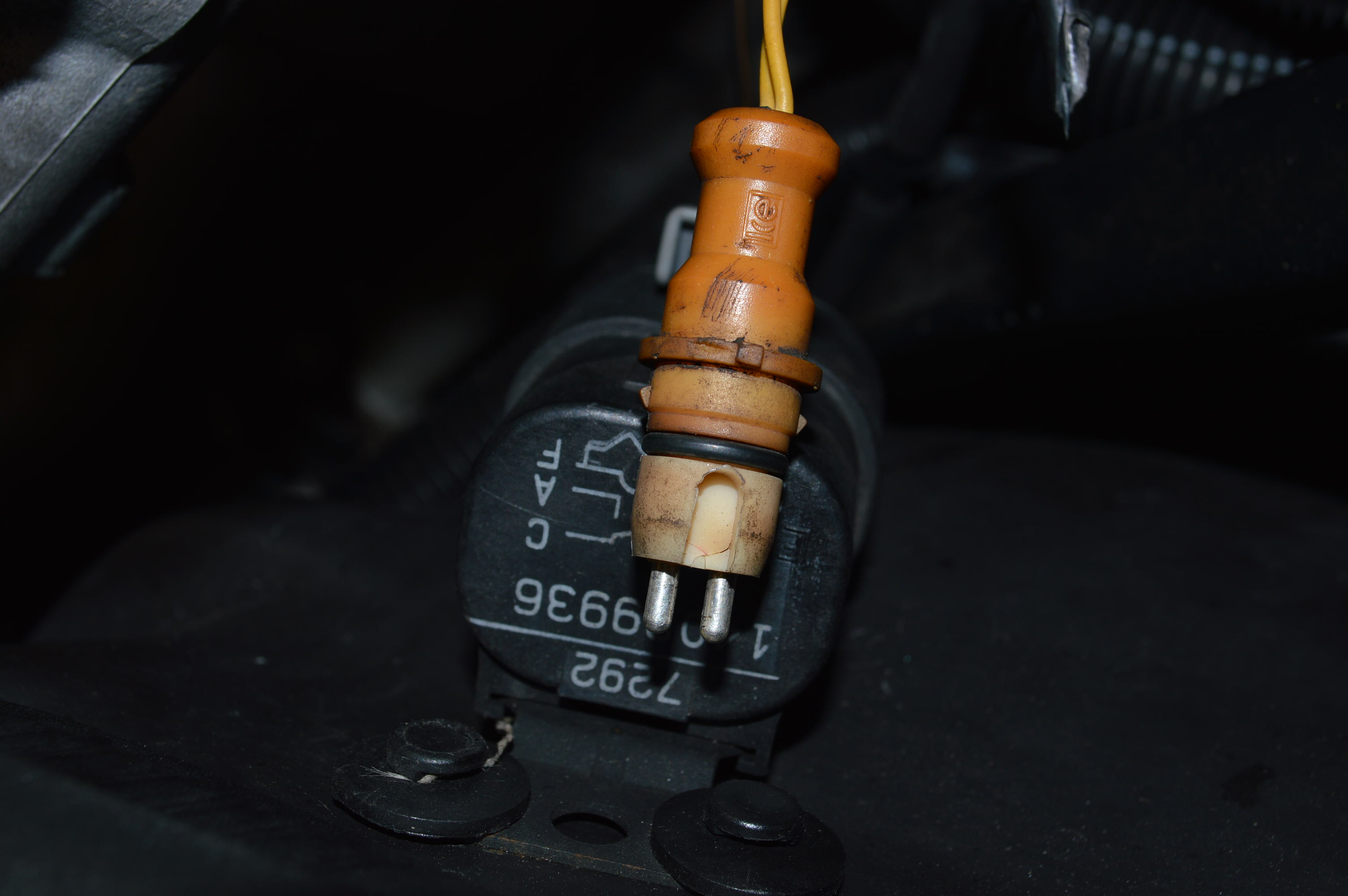

I have a 1989 Corvette convertible 5.7 pushrod motor here. ABS light comes on after you start moving or when you hit a bump. This is the Bosch II system that does not flash out codes, but requires the J-35890 tool that plugs inline with the ABS controller. I found a wiring problem without the special tool by just using my head(and a meter). The connector to the LF sensor on the vehicle side has an internal problem and needs replacement. The connector does not look like it dissassembles without cutting it up. It sort of looks like the BMW brake sensor connector....typical bosch with 2 fat pins. Short of hitting the bone-yard and snipping one out, does anyone know of a source for this?

Here's a shot of the connector.

If the wires are not shielded and you cannot find one Id consider hard wiring it?
Re: 1989 Chev Corvette - ABS Sensor Conn?
I cut the connector in half (molded). Found a wire inside that was broken. No way to reassemble it as it was before, so I just took the two male pins and pushed them into the WSS end. Weatherproofed and secured as best I could and rechecked......all fixed. At least I know there are no other issues with the ABS. Still looking for a connector. My other option would be to put in a weatherpack or something, but that would involve changing the WSS connector too. Trying not to do that, but........
