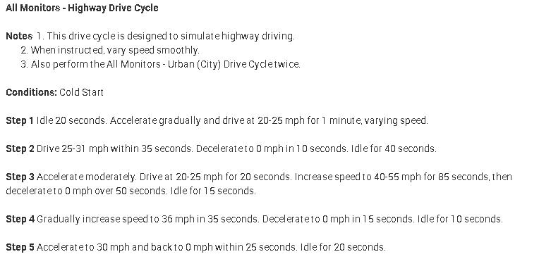

Does anybody know the OBD2 drive cycle for this 1999 Suzuki Grand Vitari? MOD does not give it.
After repairs I need to drive it to get it to pass emissions inspection.
Re: 1999 Suzuki Grand Vitari
Just a dumb service writer here....are you looking for something like.....drive for 5 minutes at 25 MPH, then 7 minutes at 30 mph?
Like this.... if so I will fax you what I have

Well, the OBD2 drive cycle is different for each vehicle. MOD gives the info for the later ones but not for a 1999 model. And, yes, it looks like the info you provided will/should work. Thank You!!!
