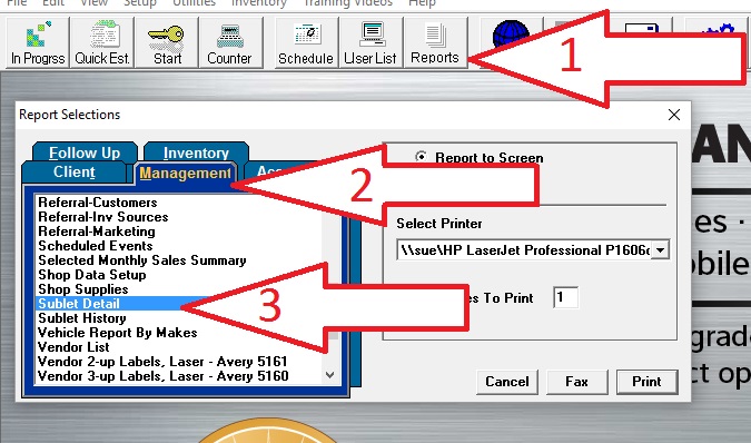

Follow these steps
1. click reports
2. click management tab
3. scroll down to sublet detail
sublet rpt ins 1.jpg (110.24 KiB) Viewed 4729 times

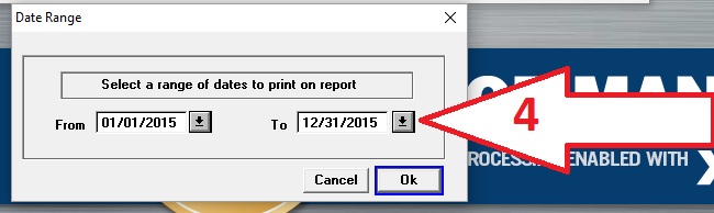

4. Choose date range I chose calendar year 2015 (NOTE.. all vendors will show grouped together)
sub rpt ins 1.5.jpg (38.49 KiB) Viewed 4729 times

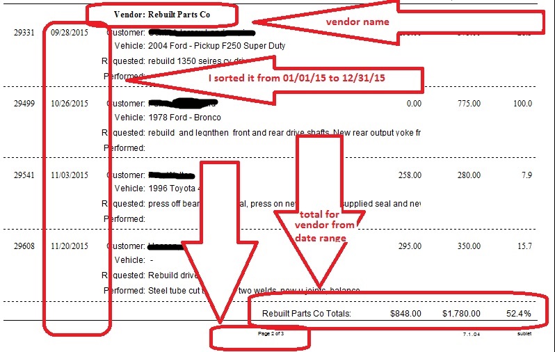

Here is a pic of the report I ran . If you look through the report, each vendor is grouped together with totals. You can not choose the vendor, only the date range. It will show all vendors with in those dates. See picture below.
sub rpt ins 2.jpg (137.98 KiB) Viewed 4729 times
I believe this is the info you were looking for.
