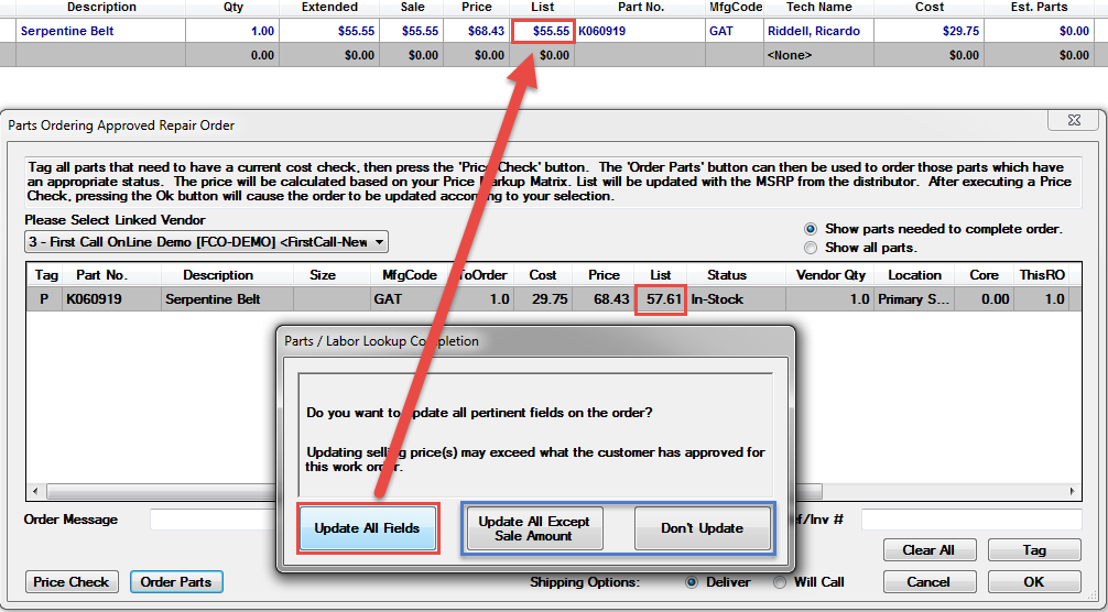

I'm now about 2 hours into testing this, including producing graphic samples. Wait, if you don't use purchase orders, how are you expecting the system to update anything automatically?

Manager SE updates List Prices as follows.
Example: part record from 1st Call catalog lists for $57.61. Ordered it by P.O. and then received it to the R.O. at $57.61 List. Since we don't have time to wait for a change in list price, I synthesized this by editing the List price in the inventory part record itself to be $55.55. Then I ran through the R.O. parts ordering process three times. It updates the list price to $57.61 (from catalog) as long as you select Update All Fields option.
Update
Update
Don't Update
Don't Update
The restock From Inventory function to restock the inventory record QOH will enforce the catalog $57.61 List.

Thank you for testing Tim.
I'll have to research using PO's via M1. We simply order items direct from WorldPac's system using a Just-In-Time approach.
Obviously the person we spoke to at M1 was incorrect--the system CAN update [pricing] automatically. But it sounds like you have to use the M1 PO system to do it.
But as far as how M1 updates parts Cost automatically thru PO's, am I correct that by starting a new PO today, you're getting the most updated pricing from the vendor(WorldPac for example) today. Then M1 uses that info and goes into Inventory and updates the Cost today?
How am I expecting the system to update pricing automatically otherwise? As I mentioned before, one simple way would be that when you transfer a part from WorldPac to an M1 repair order (M1 is already noting the Cost/List of the part on the RO), M1 could then automatically search&update the part number's pricing if M1 finds it in the Inventory list. If not, M1 doesn't update anything. Could that work? (Yes, this still wouldn't solve the issue of old Canned Jobs with 2010 parts costs, where you type up a new RO but don't interface with WorldPac, and hence M1 has no easy way to save the updated 2017 parts cost from WorldPac).
