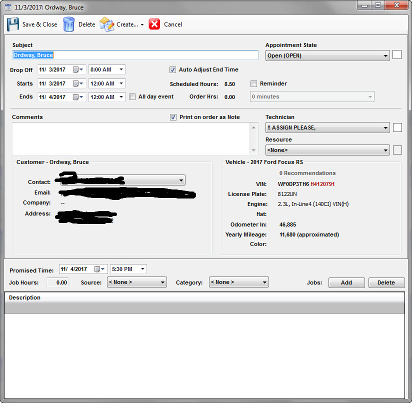

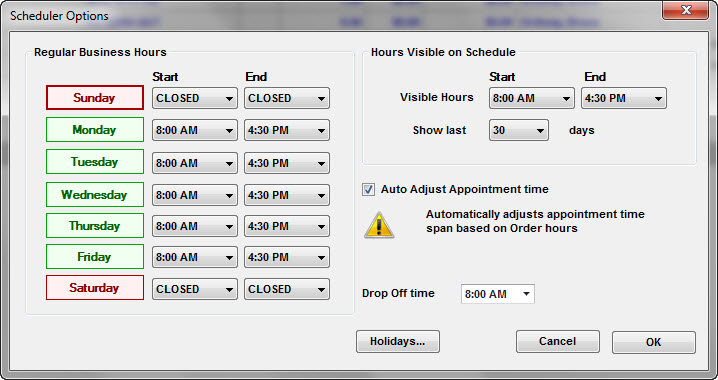

I have tried to make the 'recommended work flow' work in my shop but it is too cumbersome and offers far too many opportunities to introduce error.
Secondly this narrative was not directed by me, it was a record of the observation of the Mitchell support tech's actions. I asked him to guide me through the scheduling process based on a typical phone call I receive multiple times a day: Customer call, wants to review an estimate we gave them in the past and wants to schedule a time. His process was:
- Go to the next day with time for the scheduled work
- Right click an available time slot - click NEW
- Select the customer name ( I used my name and vehicle) [when I did this right now my scheduler defaults to an 8.5 hour job, not sure why all my parameters are set up hours of operation and such but the start time says 12:00AM, finish time 12:00 AM)
- Click create new (estimate) and Customer order comes comes up with an empty order - he went to revision, sold the revision and put it in the order, and scheduled it again under options
I did not guide him there. I wanted to know how Mitchell wants me to schedule the job in the way I am presented every day. I still don't have an answer. I am muscling through doing time calculations either in my head or trial and error. I do not assign work to techs in advance - it is not practical.
Technician work sheets that are printed after scheduling them for a future date do not reflect schedule dates.
Attached are 2 screen shots - one of my scheduler setup and the other of a new schedule window after I enter my name and vehicle.
What am I doing wrong?
