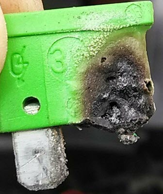

1999 Volkswagen Jetta GL. New body style. 2.0 AEG motor. Alternator tested, regulator failure. Radio has gone into safe mode 2 times. Replaced alternator, test drive, all is well. Next morning no crank, no start, have bells, dings, and radio. Checked main power box on top of battery and found all of the main fuses were good but one of the small green atc fuses was melted in the housing. It is the fuse on the inside closest to the power wires. Dorman makes a replacement box. I will be replacing it tomorrow. Has anyone ever seen this? I do not know which fuse melted.

Volkswagen has many issues with melting in the fuse box on top of the battery. On some models there is a connector under the battery, that has issues for various things as well. Seen it many times, always the first thing here to check on a VW with any issues.

I generally find that with any vehicle that some mindless "tech" has diagnosed an electrical issue and stuffed a test light probe into a fuse seat a burned leg of a fuse usually turns up. Its caused by a bad contact and as we all know loose contacts cause heat and melting. As a rule any vehicle we work on for any reason and we run across wires stuffed into seats or melted fuse insulators (fuse may not be even blown) I make a permanent note on the work order that carries through on the memo tab.
Another point I'm going to make is that I've run into a lot of electrical issues caused by loose or corroded main ground points. I've run into issues with Audi's because the ground attachment bolts run through aluminum castings into the block and as we all know thy will look great but the bolt is contaminated with aluminum oxide and therefore looses it's function. V.W's have fallen prey to this as well. Once these beauties fall victim to this they will overload many of the relays within the power distribution box or boxes causing them to stick closed overheating that circuit.
It's also important to fully test the system including the condition of the battery. If it shows anything less than 90% I consider it no good. If the base voltage is less than 12 volts (on a vehicle that shows no symptoms of a low battery and is considered fully charged) I change it. Volts act as the pathway for amps and if the path is narrow or littered things aren't going to work well. By the evidence in the picture I would say that the seat is damaged or a loose connection is present somewhere in in the circuit. Make sure the fuse amp is correct for that circuit. I've seen many issues expanded upon because some Rock Star stuffed a 20 amp fuse where a lesser amp is called for. Since Dorman makes that power box I'm thinking it's a pretty common issue but never assume and always look further. Remember with situations like these someone else's failed attempts or just plain stupid remedies become ours once we work on the vehicle.
